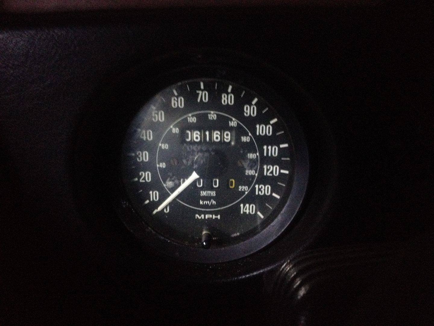

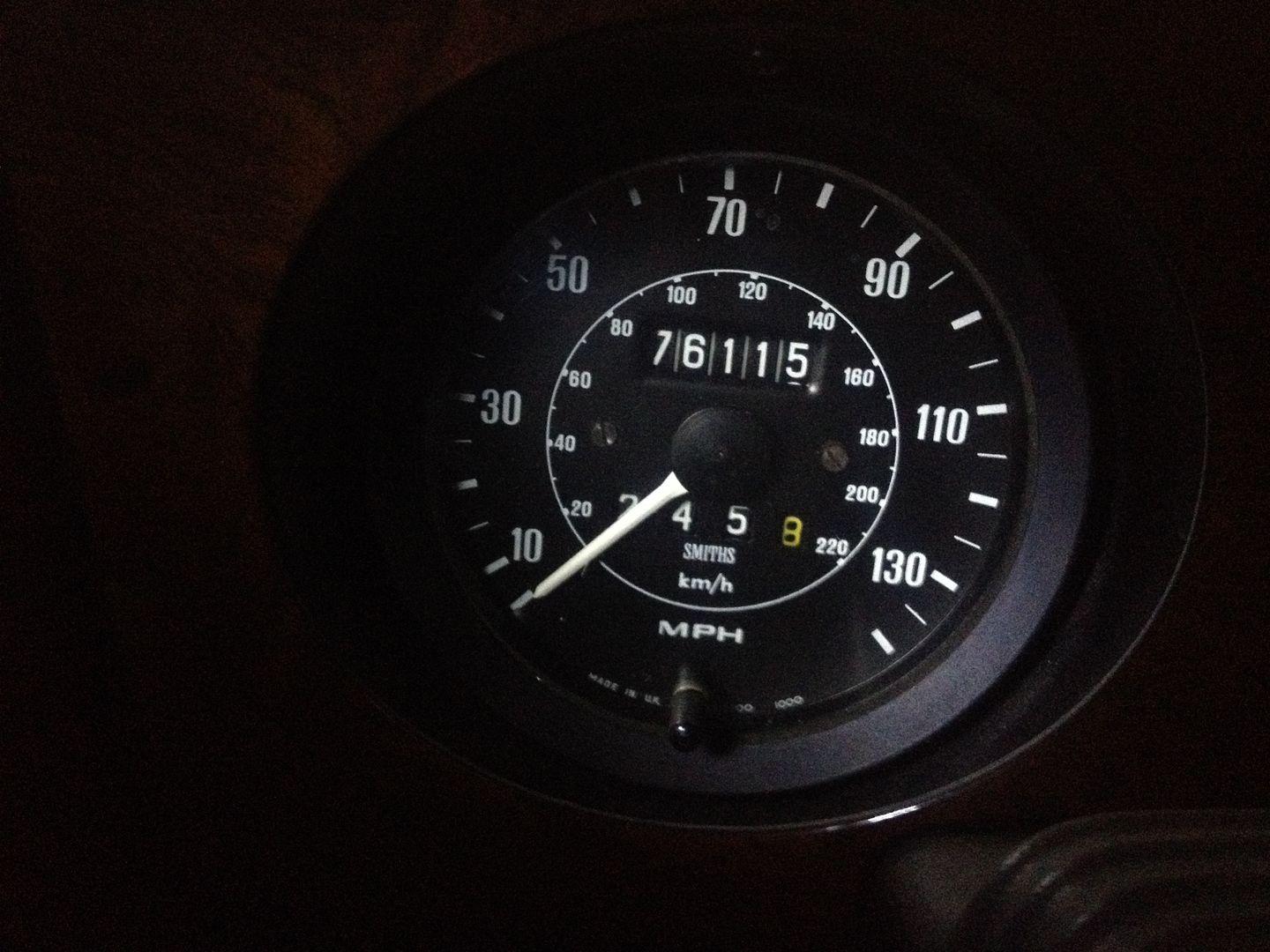

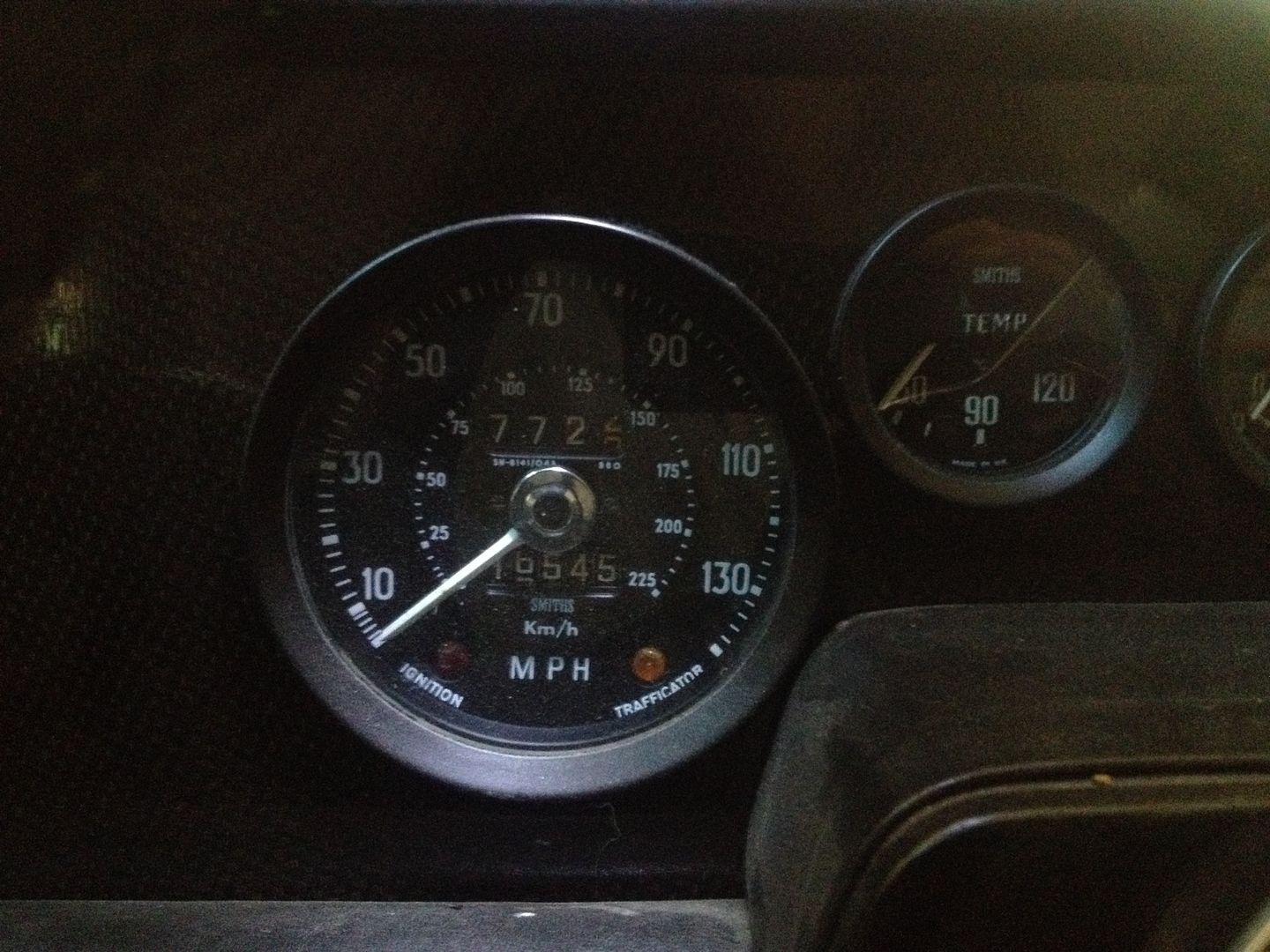

Checked some speedos today - v6 coupe:
Same as SE5:
Same as SE5a (plastic drive cable clip rather than metal screw on type):
But SE6 is very different:
And 6a is different again:

MarkHawkins
Posts: 1532
Re: Model differences 6 to 6a
Post by MarkHawkins » Sat Jun 28, 2014 9:54 pm
The speedo in OPJ 62R looks like the 6 type - marked in 10's up to 140. I presume it was changed out at some point? - most other things on the car have. Personally I think I prefer the 5a instrumentation - oil and temp gauges right in front of me.

Posts: 39866
Has thanked: 178 times
Been thanked: 1227 times
Post by scimjim » Sat Jun 28, 2014 10:06 pm
I wonder if it is an SE6/6a difference then? Could just be a stock runout early on.
One of the SE6 in the storage has the type I labelled 6a above - could just be whatever's available if you need to replace it?

Posts: 20319
Post by Roger Pennington » Mon Jun 30, 2014 12:15 am
MarkHawkins wrote:How does concourse judging work when there isn't so much a factory standard but a 'most common' configuration?
Kev or Keith (concours supremos :wink: ) may like to comment further, but essentially, within the RSSOC, concours judging is primarily condition-orientated, with little (if any) account taken of originality :w
Having said that, I don't think it's really true to say that "there isn't a factory standard" - there may be some variations, but what car doesn't have those? Manufacturers' documentation will normally contain some disclaimer along the lines of "we continue to make improvements and reserve the right to change details..... blah, blah, blah....."
Also, in the example of the speedos above, while Jim has listed 5 variations, only 2 of those would be found on a 6-on series - hardly a wide range of variation? :)
