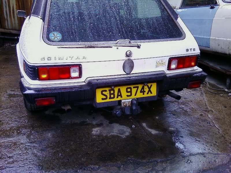

Ok guys here are the pictures you've been waiting for :-
The lights do have some official conformity markings, but I couldn't see what they were, and it was raining.......
Cheers

Post by philhoward » Thu Apr 30, 2009 7:42 pm
Thats an amazingly good fit and IMHO look pretty good. I'd be straight onto ebay if I still had a GTE!

Post by Corky » Thu Apr 30, 2009 7:54 pm
I had a full demonstration and they are pretty bright too. Better than the standard unit.

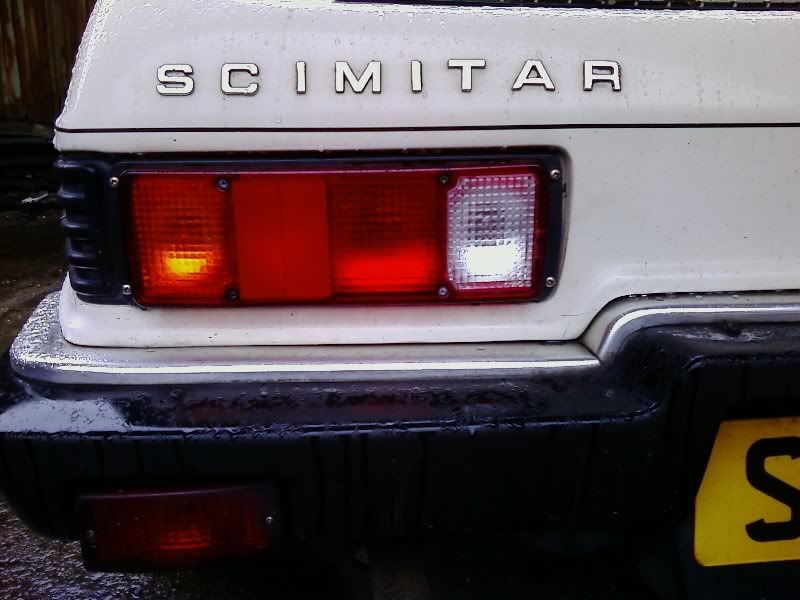

Looks a bit like the mounting screws go through the screw holes for the vent cover.
I like them, I shall have to have a think.

Post by Corky » Thu Apr 30, 2009 9:52 pm
Bob if you have a look at this pic and the technical drawing in the first post, you'll see the bit that needs cutting out (the pieces of body in between the round holes) in order to get the oblong back to fit in the bodywork. I think you'd just need to fabricate a U plate to hold the unit in place (similar to the way the door handles are held in place). Alternatively use the screw holes at each corner to secure the unit to the body.
Cheers

Post by Terry H » Sat May 02, 2009 1:43 pm
Hi All,
I just measured my SE6 rear lights and space available for these. I do really like them they suit the car perfectly, but I dont think they will fit :cry: .
I think they are 5mm on the too big side, length wise that is. my lights are 300mm, these are 310m, the space available will take 305mm but 310mm is pushing it a bit.
Regards Terry H

Post by Corky » Sat May 02, 2009 2:00 pm
Terry the extra few mm could easily be shaved off if it's a problem, which I don't think it will be as there is a slight gap either side of the existing unit.
See the top close up photo.
