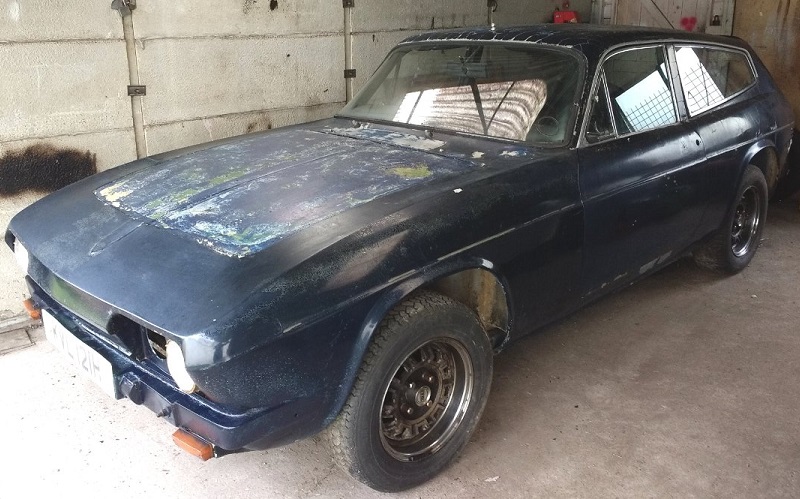

I saw this one come up for sale in May and thought about it for a while, before contacting the owner (Mike) in early July and going to have a look - being only 30 mins from where I live, it seemed a good opportunity
It was as described, a SE5 project with a galvanised chassis and a stainless exahust, various bits missing but mechanically complete and very tired paintwork!
So I decided to buy it and went back last weekend to collect it with the help of Carrie and Peter - the car was in a double garage accessed half way along an 8ft alley, in the middle of Bristol. After a bit of manoeuvring I managed to reverse my trailer up the alley and close to the garage, we winched it on, collected some other parts that Mike had for it and headed back to my workshop
Picture from the for sale advert
The paintwork is worse the other side, and the Dunlop Composite wheels need some work.

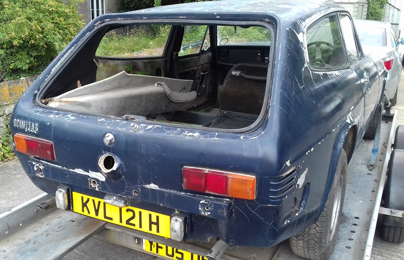

Mike bought the car in 2004 or 2005 as a project and it ended up in his garden for 12 years - this side probably got most of the sunshine
Rear hatch glass is missing and the hinge pins are broken, but Mike did give me the frame. The bonnet hinges are also broken / missing.
I've found a replacement for rear hatch already

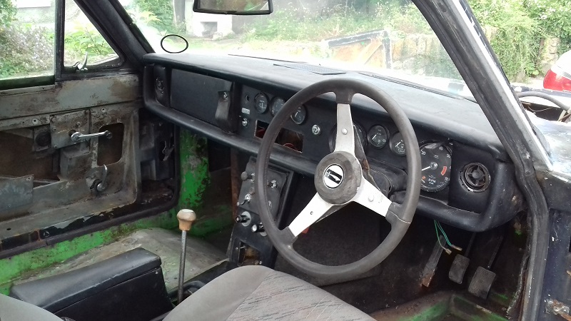

The interior is lacking quite a lot - I think someone started to make a grey interior as the seat is bolted to the floor and the rear side trim (above) has grey fabric glued on to it
Speedo shows 92k miles so it was used quite a lot until being taken off the road in 1994

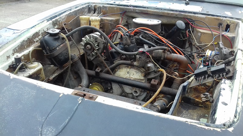

And there's some interesting "plumbing" in the engine bay - both the top and bottom metal radiator pipes have been replaced by copper pipe soldered together to make the appropriate angles :?
Mike said he had the engine running when he first bought the car but it hadn't run for at least 10 years. There was still wiring and a switch in the engine bay, as well as a pipe from the fuel pump leading to the nose. The oil looked clean and there was water in the expansion tank.
In the workshop, I checked the fuses and found there were none except for one 13A household fuse :shock: in the position nearest the engine.
This was removed, along with all other unecessary connections until I was left with the coil hard wired to the battery side of the starter solenoid and a switch to engage the starter (the alternator was also wired to the battery side of the solenoid). With a battery connected, the engine turned over well so I put the fuel pipe in a jerry can and cranked again.
No signs of life, or even fuel so I top the top off the carb and filled the float chamber with fuel.
Tried again but still nothing and when I checked the spark there wasn't one.
The points looked good, but I cleaned them up with some fine sand paper anyway and this gave me a spark and signs of life.
So another crank with the choke flaps closed and working the throttle lever, she started and ran smoothly :)
A bit of smoke out the back, but nothing to worry about and I let the engine warm up. After 5 minutes she was idling nicely and 70 psi oil pressure :D
The engine looked original - it has a front bowl sump, dipstick in the front cover and the 40 DFA carb, but from what I can make out of the engine number it's not original to the car.
