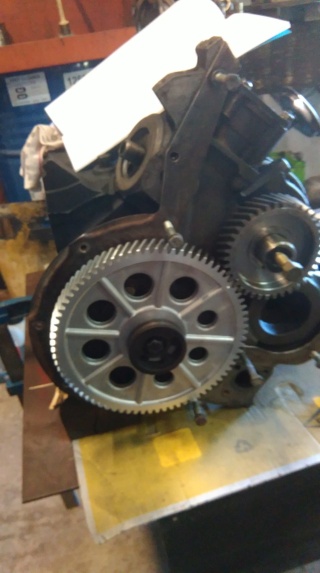

I have advanced since the month of may. The engine has been totaly rebuilt, cleaned, repaint , new timing gear set, block rebored, new pistons +0.030, new crankshaft bearing, etc.
Now ready to come back to home :
and previously, the nice new timing gear :
Next step, fit le gear box to the engine, but I can't find the tightening torque for the clutch housing in my manual. I'm waiting also new rubber mouting supports before to put the engine in the car :)
