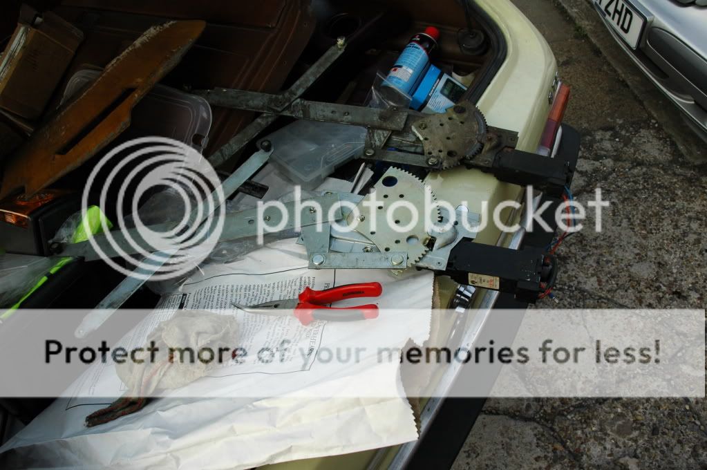

New window motors arrived yesterday tea time so set about fitting the drivers side one today and had a play with a few more bits. The part no's from Rimmer Bros BLP1068 & 1069 that Mick suggested are correct only one part needs swapping over, I lowered the window right down and then removed the 4 bolts from the motor side and then the two others nearer the lock end and then lifted it all together with the glass and slid the motor off, I then lowered the glass down and lifted the motor out. I checked them side by side and they are an exact match.
I then removed this part from the other mechanism, cleaned up and then fitted to the new one.
All that was left to do was to remove the plug on the end and fit two bullet connectors to the wires ready for coupling back up. To fit I lifted the glass up and supported it while slipping the scissor part back on to the runners on the glass support, I then fastened one of the motor bolts and both of the other screws in at the lock end and then switched the window up until all bolt holes lined up and then fastened the remaining bolts in.
I then fitted the new switch that I had purchased (much easier than swapping the wires over) and all works fine now:- well almost, its not as smooth as I thought it would be and still struggles when about half way up, put the multi meter on and getting 12 volts for down and 11.7 volts for up when motor dissconnected so dont think its anything to do wth that. I think the rubber window runners are shot as I have mentioned previously someone has filled them with copperslip which I have removed and sprayed 1 tin of silicon spray down them to clean them out, every thing is greased and free but I have also found that there are two rivets below the door lock that faten the window surround in place that are very loose and have about 1/4" of play on them, this could have a bearing on the operation but will not rectify until the new rubbers come and I fit the new window surround.
