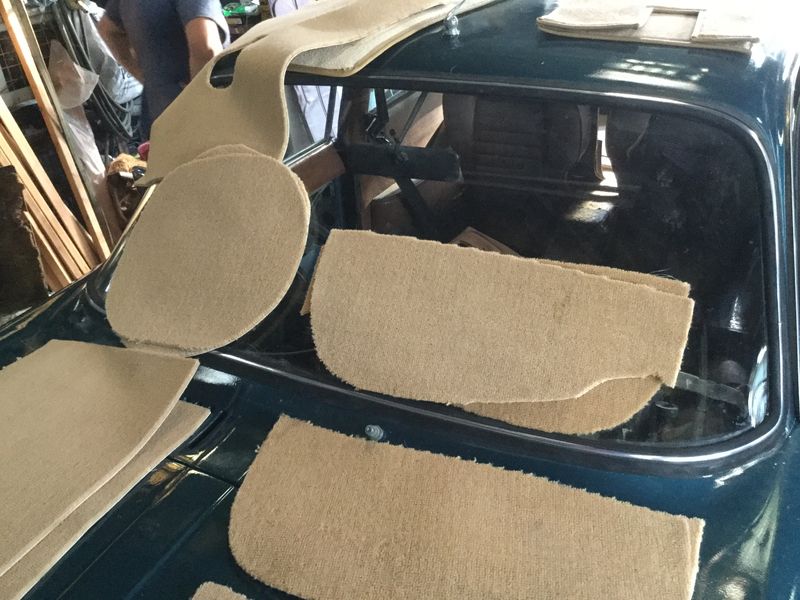

I've already complained to them but of course they've never had a problem and could I take lots of photos and explain which bits didn't fit. There were no pieces for the SE5 centre console or under dash and the forward and outer footwells took lots of cutting.
I'm putting together a full complaint but here's a pic I took for the bits that did fit.

That's one hell of a lot that don't fit Jim. :(
I found the drivers side runner was shorter than need be, the passenger was better. Which bits fitted ok? I'm tempted to write a large complaint too. Also to the trading standards as they state they are cut to manufacturers standards or whatever it said.

Post by scimjim » Fri Jul 08, 2016 9:38 pm
That's atrocious!
This is the front of my trans tunnel piece - gearstick hole in the wrong place and at the rear it was too wide.
And the fully edge bound drivers side front bulkhead needed cutting to bits - the red line on the cardboard is the original shape.
Most bits that were edge bound didn't need it (or it needed cutting off) and pieces that did need it weren't. The only bits that fitted (or to be more correct, were only slightly out) were the long pieces from the front footwells, under the seats to the rear footwells.

Chgperformance wrote:I'm struggling to find the right bits for the seat well outer wall in the rear.
semi-circular bit, top right of my pic (flat face downwards). the front edge is rounded instead of square but if you modify the sill sections slightly you can cover the gap.

Have been fitting a kit from QRG into an Se5a, same as these kits here I think, just awful.
The last pic in James' first post, any idea what it's supposed to be!?
The rear seat side panels are stupidly too small...
I had to cut the transmission piece quite heavily it was so long, masked the cut with a nice fold.
