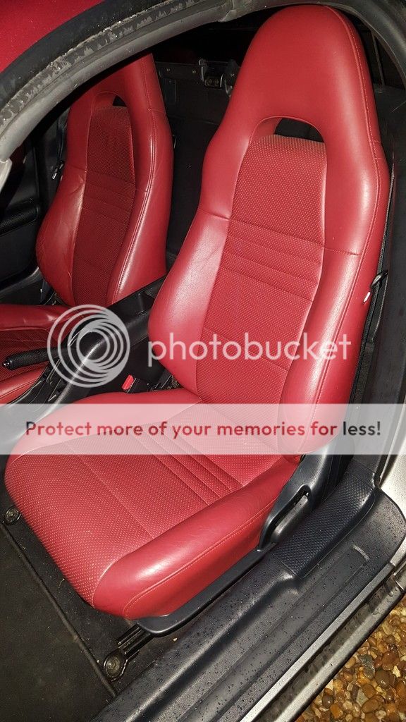

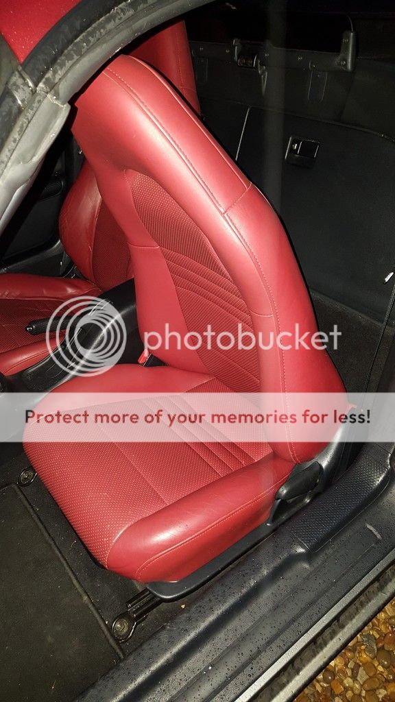

With my above warning out the way, as another option to throw in the mix of alternative seats, I have a MR2 mk3. Although it's only a 2 seater, the seats tip forward for access to the storage lockers behind the seats (there is no boot). The tip lever is at the side, it's the same lever for the recline, not seperate, so it only returns to the formost lock position. The drivers seat is height adjustable (passenger not). Leather & cloth options. The last models 2005-06 had an option for heated seats. I've not done any measurements, but here are a couple of photos:
