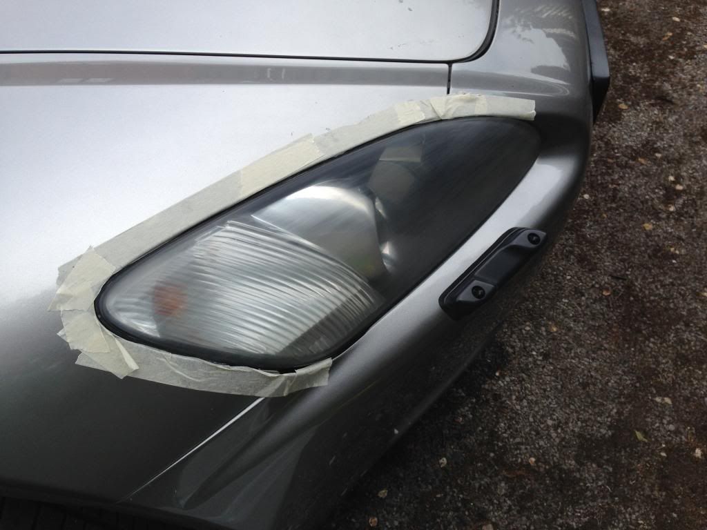

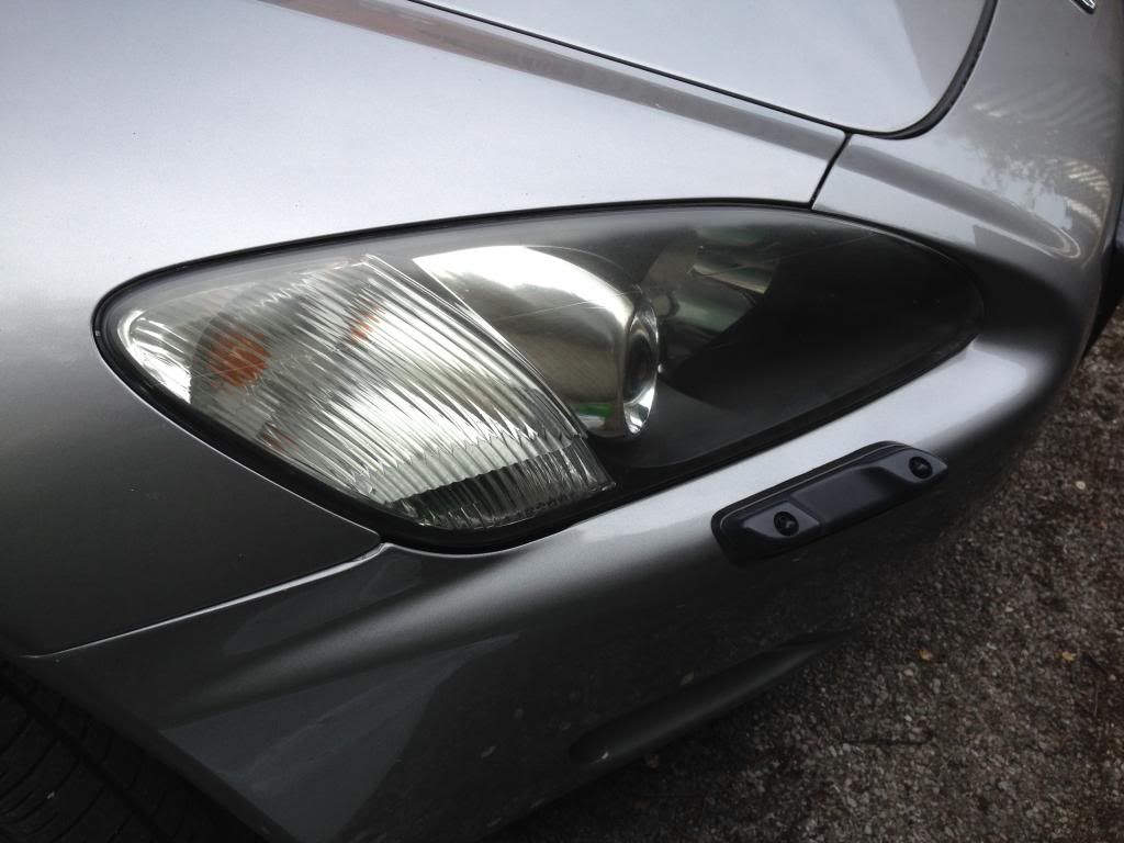

Not relevant to any scimmy headlamps, but suitable for scimi rear lamps etc. The lights on my S2000 where sligtly yellowed and had lost a bit of their shine - nowhere near as bad as I have seen but wanted to polish them up. This discoulouring and crazing is in the very top layer of the plastic, and needs removing.
Before;
Masked and then rubbed down with wet 2000 grit wet and dry. It's slow, but doesnt leave any hard scratches. The water comes off with a yellow hue to it to start with, but as you get through the top layer it eventually ends up coming off like milk;
Lastly I polished them back up with T Cut, then autoglym high resin polish;

In the photos it doesn't actually look too bad "before", until you see the "after", and that's a really big improvement! :D
As an alternative or addition to T-cut in the polishing stage, I've found the plastic polish that I bought from RR to do the SS1 rear window, is pretty good on plastic light lenses too. :)

The discolouring was mainly on the top edge, and wasnt bad at all, but was noticeably yellow in sunlight. Well worth the hour or so it too, and a couple of ££s of wet n' dry.
A better cutting compoud would be better, but I only had T cut and it did the job. I will probably revisit them in a couple of places as theres still a few stone chips that need to be polished out.
Ideally they need a UV protection putting on after or they can start to go again, but much quicker as aparently I will have removed the factory treatment.
The photos also highlight that the front bumpers a slightly different shade of silver, and not quite fitted right. Its only done 38k but its had both bumpers repainted. Otherwise its pretty spotless.
Craig - washer bottles come up really nicely in the dishwasher too! Sorting the lenses takes years off the look.
