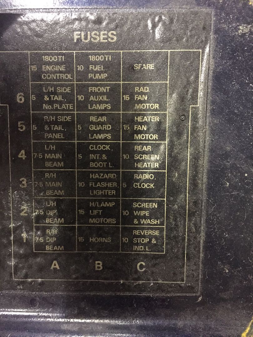

You haven't by any chance removed a fuse from the fuse box that looks like it's a spare ?
Posts: 11553
Has thanked: 357 times
Been thanked: 255 times
Re: Sabre 1800Ti Problems Starting
Post by Corky » Fri Sep 02, 2016 9:57 am
It's 15 on this photo :-
The dark blue 15A one on the right 2nd row from the top.
