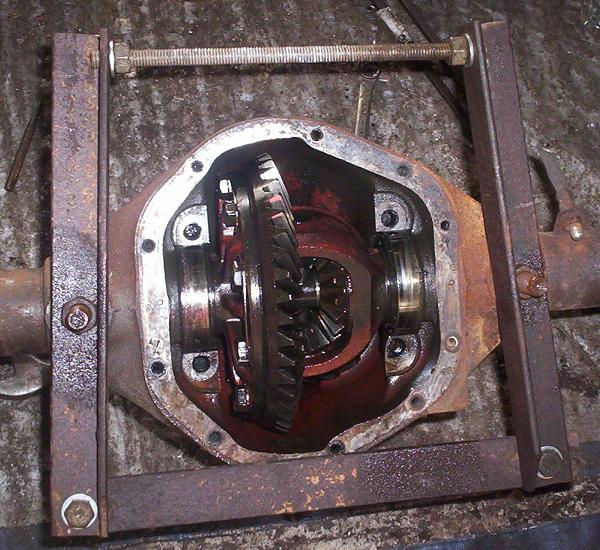

The diff may come out without a spreader, but it's easier with one
You need to keep the diff bearings parallel to the case
I made one from 3 pieces of angle iron, a length of 1/2" threaded rod and 2 M16 bolts with the heads turned down to fit in the 2 recesses either side of the diff casing

Never occurred that I could make my own spreader! I should have some angle iron lying around. I'm imagining a "U" of it, with the threaded rod on the open side to provide the opening force. But doesn't the rod have a tendency to bend under the strain?

Yes, a "U" shape with the threaded rod on the open side
You're only stretching it a fraction to overcome the preload on the bearings, maybe 1mm or 2mm at the most
This is why you can get them out without a spreader

This is a pic of my spreader
Slide hammering should work, but I've also removed halfshafts by removing the wheel cylinder from the back plate and putting a threaded rod through the resulting hole to the bracket on the axle and winding it out. I thought I had a pic of this but cannot find it. Also be careful not to bend the axle bracket if you try this...

Thanks for the picture Gavin. Pretty much what I imagined, save that I had all the angleiron facing the same way, which is silly because they wouldn't fit together properly!
