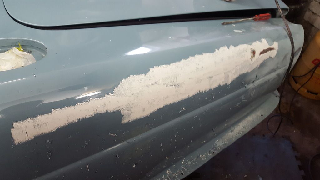

So the strip down has begun. It's going to have a full respray which will hopefully be done at SP Automotive (the same company that did GTC 404)

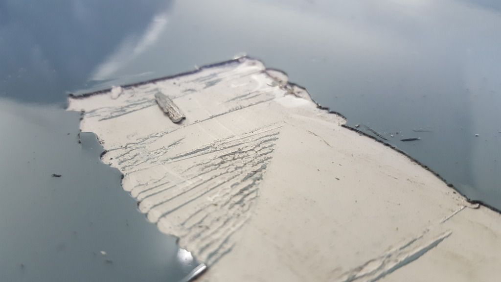

Here's showing the slight difference in colour between the original and the previous respray
They used a lot of filler primer too but I'm optimistic that it was down to saving time than hiding anything nasty

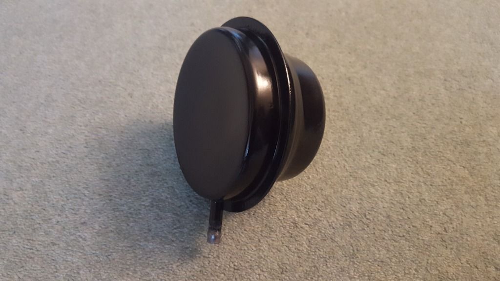

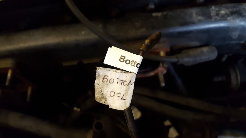

I won't bore the Internet with all the photos I took to remind me where everything goes and how it was routed as there's a lot. Things like all the heating system, which is vacuum controlled and therefore has lots of pipework and a reservoir tank - which I've already blasted and painted :)
One revelation is the use of a label maker instead of tape for labelling things. The writing is actually legible and doesn't rub off after two minutes

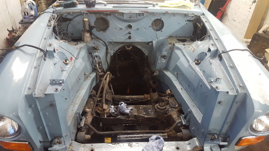

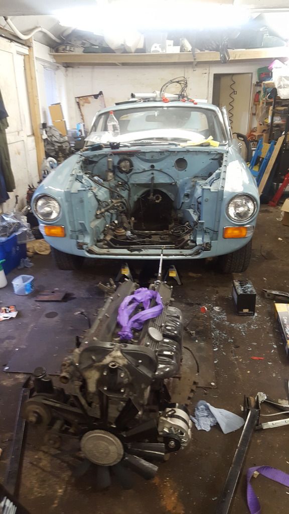

Out with the engine and box
Leaving an almost empty engine bay

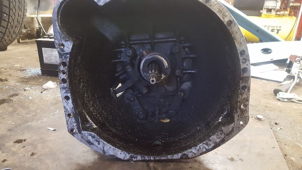

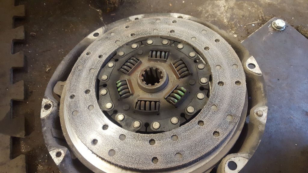

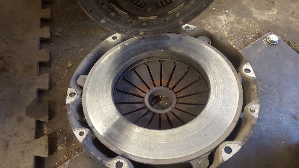

Gearbox removed. Definitely an oil leak or two

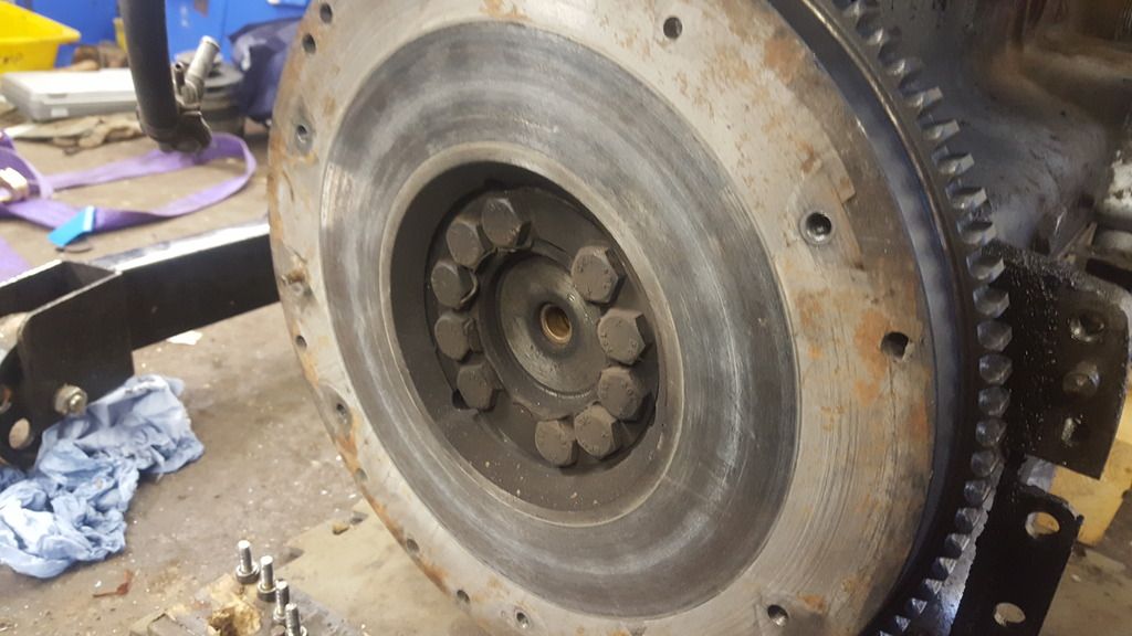

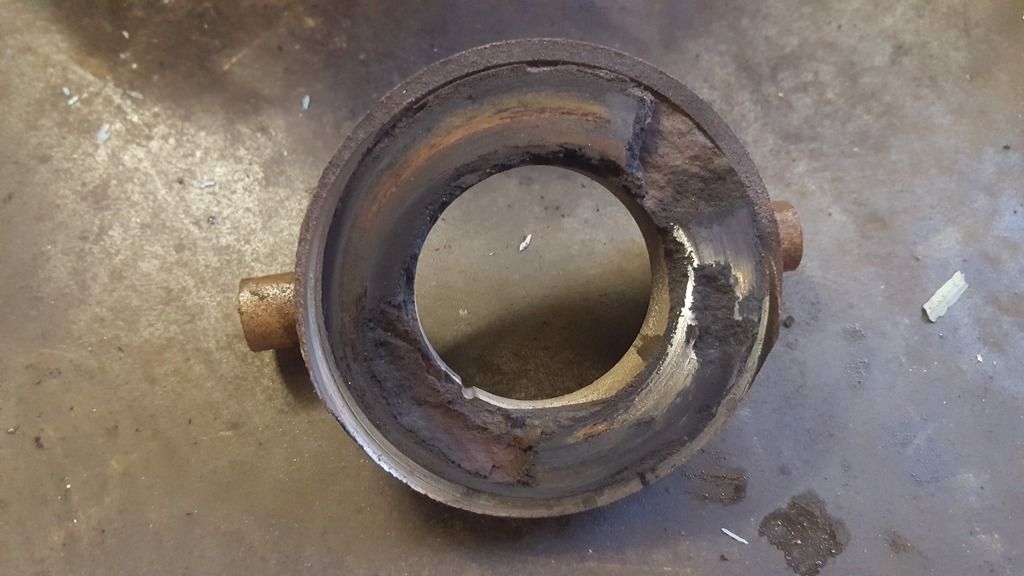

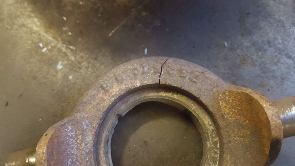

The eagle eyed will have already spotted it but here's what failed
The rest of the clutch is in mighty fine condition, as is the flywheel. The flywheels on XK6 engines have a tendency to wear quickly so this kinda proves the mileage

"Just" a release bearing needed for the clutch then? Bet that's a relief!

Yep, a £20 odd bearing :) although I want to get the pressure plate checked for damage just to be safe.

The vacuum tank was shot blasted then primed and painted using Autosmart aerosols. The finish is pretty good so I did a few more bits in my lunch break today. Powder coating is great in theory but it's too thick for a lot of things, plus doing it this way, it costs me nothing :)
