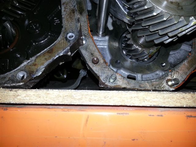

one of the issues with ss1 turbo box, all s13 and early s14 boxes is the oil transfer ports in the cast steel centre plate, which allows too much oil flow from gears/selectors section to flow into the tail section (selector rods only), starving gears and bearings and flooding tail section.
i have pics which will show which ports to fill to blank off (use JB Weld or ally epoxy). for a compie box its well worth doing and not a big job witj box on the bench. Cant post as laptops not with me and pics on there

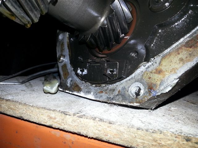

yes, both Stews and mine have S14 boxes, late model in my case with the 'gated' oil transfer port.
this is an S13/early s14 centre plate. Smaller oil transfer hole
the two side by side for comparison

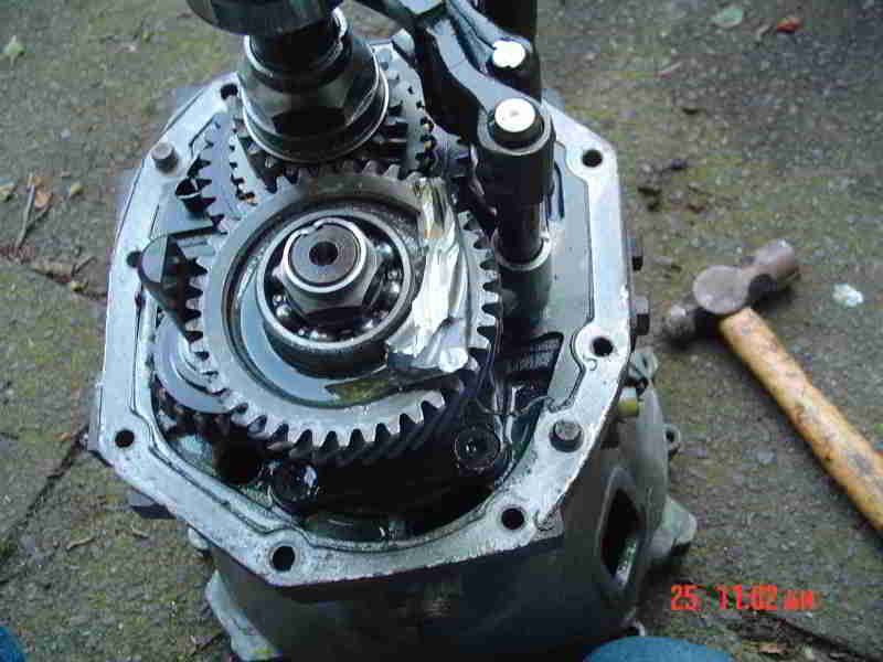

this shows a Mk2 silvia (late model Scimitar box)
you can see the larger oil transfer port and secondary round one also

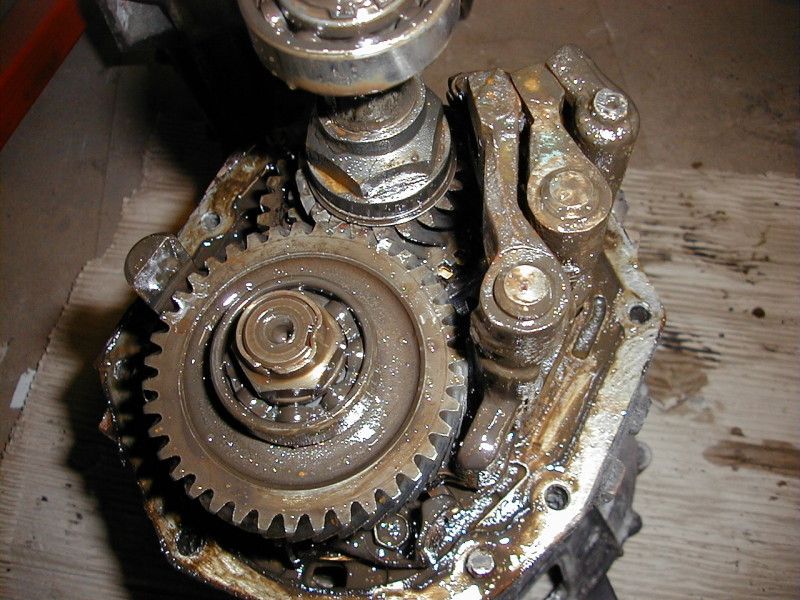

pic below is an early s13 box (largely the same as s12 Mk2) except the oil transfer hole at the bottom is reduced in size by half
pic below shows a typical S12/13/14 centre plate and the possible oil holes are shown ringed in red. On this one ALL have been blanked off. The oil level is filled and checked in the official Nissan way through the side filler hole in the casing and then a little oil added via the gear lever hole purely for the rear selector rods etc (not selectors themselves, they are in the main case)
