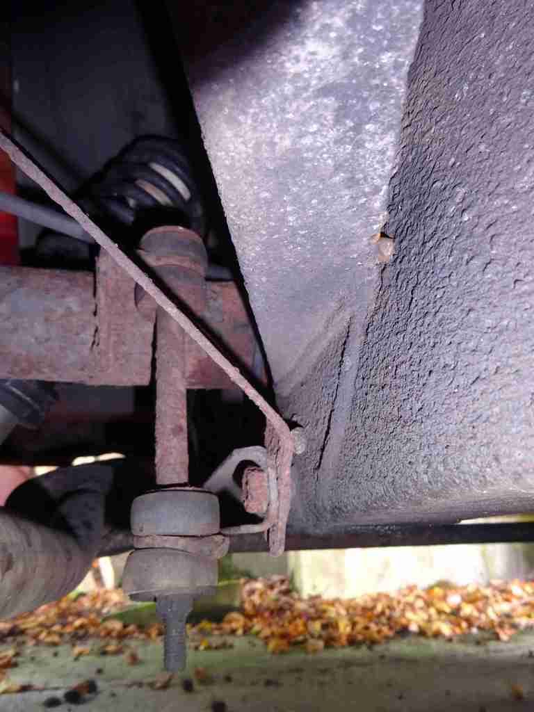

Roger Pennington wrote:The longer link in Will's photos looks very low - lower even than the exhaust - so they may have found it was too vulnerable? It doesn't look as though it would need to be as short as the short one, though, just to ensure it doesn't stick below the chassis?
Good point and it does look as though end of the MB14 ARB may have had a clout at some time.
Unfortunately, any shortening at all of the long link is taking us back to the problem. Can we devise a better arrangement?
For what it costs I'm thinking of trying Corkys suggestion:- "The longer link looks like the SS1/Chevette/GM one. Used on lots of cars and available from around £12 a pair. They're easy to shorten if need be." If I do give it a try then I'll fit the centre bolts t'other way up (bolt heads to the bottom and free thread at the top) which should give another inch or so ground clearance.
The drop link on the left is a standard SS1/Chevette link, the next one along is from a Daewoo (Nexia I think. very cheap nowadays, as there's not a lot of demand :lol: ) . Then on the right of the photo is the polybush kit with part number SPF2092BK. As I say, the links are very easily shortened to the desired length. You may need a die nut to extend the bolt thread though.

Will Anderson wrote:As promised, photos of MB14 and MB46 drop links.
MB14
MB46
Let us examine these two different droplinks and determine which is correct.
One of them long and the other short
One has the rollbar level
One has it pointing upwards
One has possible ground clearance issues whereas the other does not.
I have already mentioned that the Short link is not correct or as the post heading states the bar is upside down which gives the severe upward angle of the rollbar.
The ARB's in the photos have horizontal mashed ends with a plain hole (not threaded or tapered) by the look of things. This is then fitted to a pin ended droplink which fastens via a pair of pad bushes, compression washers and a compression nut. The idea is that the ARB end hole and droplink rod diameters are such that the bar can articulate without the pin contacting the hole and bending at extremes of travel. This is clearly happened with the short link, and not with the long link. The reason the short link is bent is that it has pulled the bar ends up at static ride height, using up all the slack in the bar end hole. This allows the pin to jam in the bar resulting in the damage shown. What you require is a bar end that sits near to horizontal with a vertical pin so that at static ride height the angle between the pin and mashed end is near to 90 degrees. This will allow greatest articulation in both suspension compression and extension, however a bit of adjustment may be required to get angles, clearances, etc, correct for individual vehicles depending upon wheel diameters, tyre diameters, springs, ride heights, etc.
So given the two photos, the longer rod looks to be more correct. It is common for droplinks of this type to be bent with today's curbs and potholes.

IMO I think you can dismiss the issue of "fitting the arb upside down" as theoretically there's little or no difference between the upper and lower faces, and the horizontal-ness or upward-sloping-ness of the ends is entirely due to the drop link lengths. The arb should pivot fairly easily in the chassis mounts (with drop-links disconnected);the arb is only ever stressed when one wheel either bumps or droops.
I think the drop-link length can be determined by ensuring the arms are horizontal when the suspension is at rest; movement up and down will then result in an arc that introduces the minimum of bending forces on the drop links.

I've opted for Chevette drop link (thanks Corky) fitted with ARB bent ends facing upwards (as I found it). Drop link spacer tube in my original set-up measured 30mm whereas the Chevette spacer now fitted has 75mm length. I fitted the through bolt with its head at the bottom and find with suspension in neutral position it does not hang lower than the chassis so shouldn't present a ground clearance problem.
It will take time but if a problem arises I'll post an update.
