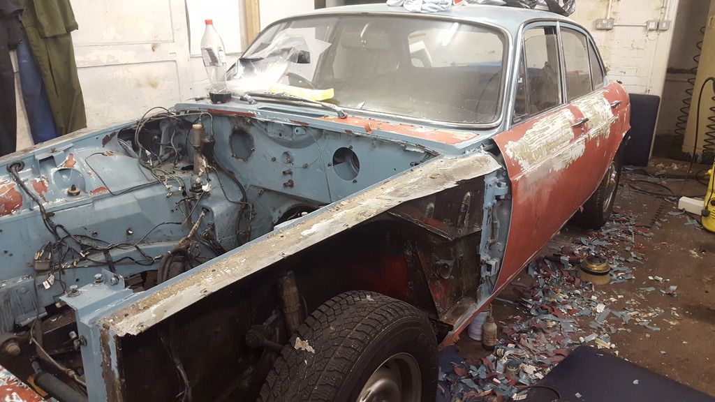

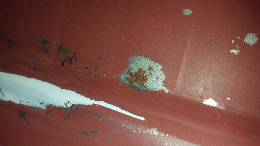

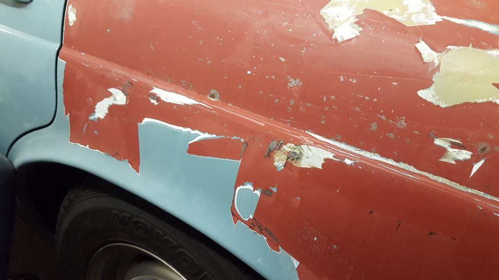

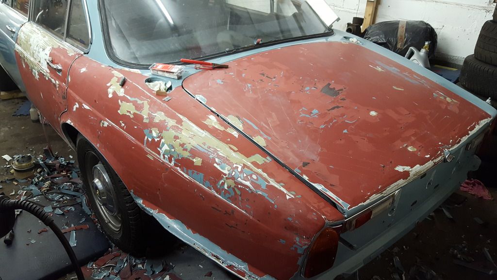

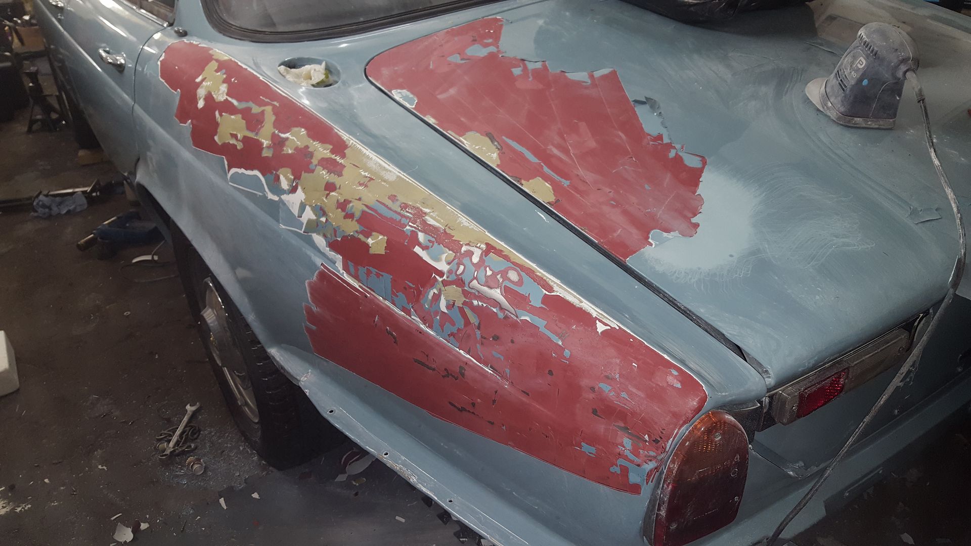

As I've not posted in a while, have some photos. I'm still astounded with the condition of the metal work. I've only found one speck of surface rust, the size of a pea on the whole thing. There was a little bit of damage lurking at the back but nothing too bad.

Shock, there has actually been some progress on the Jag. The photos speak for themselves
Here's another look at how rust free the car is - this is the largest bit of rust I can find.
Photo for scale
