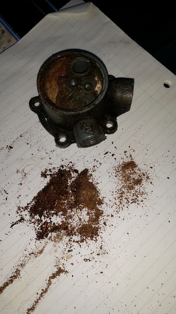

Thanks Geoff and Roger. I have fitted the cooling system, and two thirds of my exhaust off ebay. The rear box is wrong but luckily a spare rear silencer off a Scimitar fits ok. The mechanical fuel pump is no good, it was completely choked with debris. It still wouldn't work after cleaning. I have fitted an electronic pump which is easy to fit and works ok. I got a blanking plate to cover the hole the old pump left from my pack of spares off ebay. I want to fit the clutch pedal and hydraulics next, so I can test the gearbox and back axle

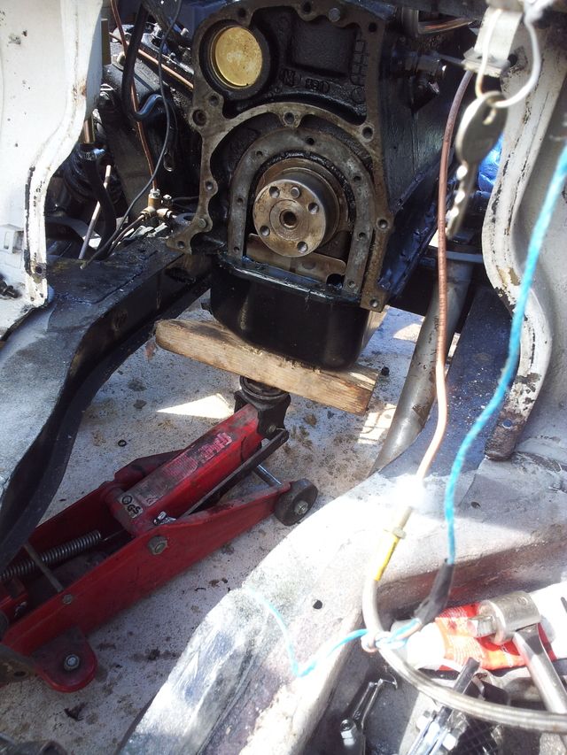

I had a bit of a set back today. I ran the car out of the garage, the brakes,clutch and gearbox worked fine. I had seen some oil on the floor underneath the engine before I moved it. I thought I had been a bit careless when filling the engine with oil, but when I got the car back on the lift and had better access I could see a leak coming from where the engine and gearbox join. This could be either engine or gearbox oil. I have put a container under the area and will have a better look tomorrow. A smell and taste test should reveal which is the source, either way it is going to be engine and or gearbox out a lot of work to replace a £4 seal. When I bought the car it didn't have any oil in it, how long it had been empty I don't know, this may have caused the seals to dry out or as I have found before, they can get stuck to the crank and on the first start get damaged.
This engine is from a Mk4 Spitfire so hopefully will have a proper crank seals and not one of those ineffective scroll seals. The WM says a special tool is needed to line up the rear crank seal holder. This slides over the crank and makes sure there is an even gap all around' I have managed to line up similar set ups in the past by wrapping a couple of turns of PTFE tape around the shaft, mounting the seal holder in place and then carefully pulling the tape out. My only concern is that I won't be able to resist on checking the main and big end bearing shells, the end float shims and oil pump so a £4 seal may cost a lot more!!!!

I have now suspended the rear body tub and the chassis is free to be wheeled out. I now have very good access so I am considering removing the gear box and trying to replace the rear crank seal with the engine in situ. I need to take the propshaft off to replace the diff seal so to take the box out won't be a lot of extra work. The gearboxes on these Triumphs are lifted out and aren't too heavy. I may do the gearbox seals as well.

I have got the box,flywheel, clutch and back plate off. The seal housing came off without damaging the sump gasket.
The seal didn't look too bad but when I checked the end of the crankshaft I found something stuck to it. I suspect that part of a seal had stuck to it. The oil leak looked recent and wasn't extensive. So either the present seal had stuck to the crank or it had been replaced without cleaning the crank properly. Luckily for me the crank is smooth with no wear ridge. I have fitted the new seal and gasket and with silicone gasket cement I have bolted it back on. One thing I found is that someone had taken a chisel to one of the bolts that hold the clutch cover on, this made it very hard to get a socket on. The bolts are very tight and an ordinary socket won't go on the nut. I had to use a 1/4" socket with an adapter to fit a 3/8" wrench. I have replaced the damaged bolt, whilst I can understand the need to use a chisel in some circumstances I don't agree with using the damaged bolt again.
So with all 3 seals replaced and a new clutch courtesy of the PO I can put the gearbox and propshaft back on tomorrow.
