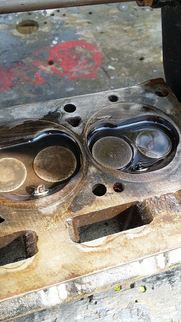

I had chance to do some work on the Equipe and sadly the information given pre sale was not quite the truth. The master cylinders I was told had been renovated, on checking old manky seals were found. I was also told that the head had been off, decoked and valves ground in. I did a compression test and found all four cylinders below 100psi with number 1 down to 70. I took the head off and whilst it had been decoked, the head gasket didn't look new. The block and the head surfaces still had traces of old gasket.
I did the inverted test and poured white spirit into each chamber.
Within minutes all the ports were wet and no1 chamber was nearly empty. So work on the head is need. I am just glad I didn't accept what was said and double checked.

After a couple of weeks away at Easter I was able to get back in the garage. I have found a company in Warrington that will fit hardened exhaust valve seats and give the head a skim for about £200. I dropped the head off this afternoon and it should be ready next week. 2 local firms didn't even give me a quote. I have placed an order for some parts from Paddocks at Chester, I have got freepost if not it it isn't far to collect them. As recommended I have gone for a Payen gasket set. I have also got the correct fan blade for the later Spitfire engine , it is plastic and has more blades. I have got my electrolytic rust removing tank set up, and the first batch of parts will be ready tomorrow. If anyone has rusted parts to clean I can highly recommend this system. The parts come out black but with a rinse under a hose pipe and a very light rub over with a wire brush the steel comes completely clean.

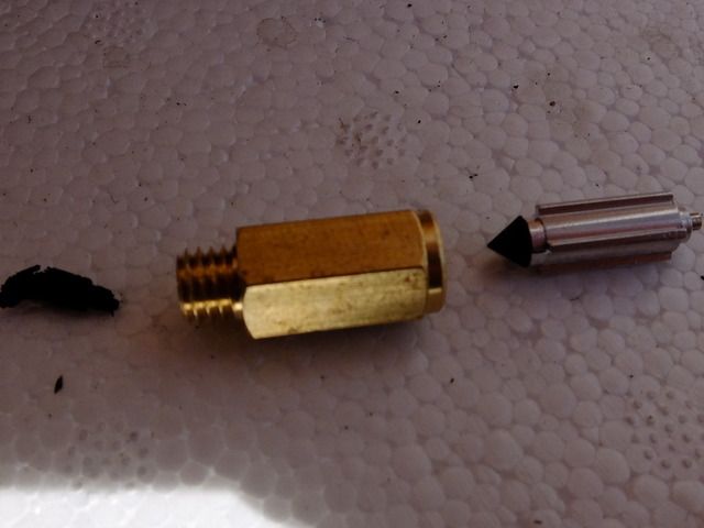

The Bond is fitted with twin SU carbs, and whilst I am not in favour of messing with them if they function OK, my pair look neglected and the controls are stiff. A check to see if the slide valves work ok resulted in one being stuck at the top and one halfway. SUs are simple carbs and I must have dismantled and serviced dozens over the years. The first one came apart with no dramas and wasn't worn, it is the type with the choke operated by a lever lowering the main jet. I was pleased to see that the needle valves was made from viton and didn't need replacing so I cleaned it up and reassembled it. The second carb was a different matter. The main jet was stuck in its holder/adjuster and could not be persuaded to move.
screen shot windows
The brass holder is at the bottom and the main needle is firmly stuck to it. I also noticed that the little collar that fits inside the lever which attaches to the plastic part of the needle is missing. This little collar allows the screw to be tightened without trapping the lever. It is obvious that this set hasn't worked for some time and the main jet has stuck in the up position.
I have soaked the whole thing in plus gas and will leave it overnight. The problem is the brass collar it will be difficult to hold it without destroying it

How do Ray. Could you use differential expansion or is this viton stuff susceptible to warmth?

The Viton is on the tip of the needle valve,in the top of the float chambers. I would fit new jet supply pipe assemblies.Here is a snap of one of the Viton (that is what the tip material is in the picture) needle valves from my MG,the crud is from the fuel line (a long story).One thing,when you have the pistons and chambers cleaned up,just with a touch of petrol,don't use any abrasive.It is worth doing a drop test,just plug the holes in the pistons and they should drop in about 4 to 5 seconds each.Burlen keep all the spares you need.S.U.s are superb once you have set them up.Here is a link to a good site(the guy knows his onions!)
They are,at a guess HS2s,so easy to rebuild,Mark One Spitfire?
http://sucarb.co.uk/?SID=d7n8jdfhttdlne ... __store=su
http://www.mgb-stuff.org.uk/fueltext.htm#sucarbs

b.c.flat hat wrote:How do Ray. Could you use differential expansion or is this viton stuff susceptible to warmth?
The ones I have are spring loaded
747PETE wrote:The Viton is on the tip of the needle valve,in the top of the float chambers. I would fit new jet supply pipe assemblies.Here is a snap of one of the Viton (that is what the tip material is in the picture) needle valves from my MG,the crud is from the fuel line (a long story).One thing,when you have the pistons and chambers cleaned up,just with a touch of petrol,don't use any abrasive.It is worth doing a drop test,just plug the holes in the pistons and they should drop in about 4 to 5 seconds each.Burlen keep all the spares you need.S.U.s are superb once you have set them up.Here is a link to a good site(the guy knows his onions!)
Thanks Pete I have dealt with these people before, very good. I managed to get the jet out using a wooden dowel, and after cleaning everything up the and resetting the main jet position the piston slid up and down nicely. I have never timed the drop Pete, if it drops with a nice thunk I am satisfied. I am going to refit everything when my head returns and try them out. The beauty is that they are so easy to get at if they need further work its a doddle to take them off.
