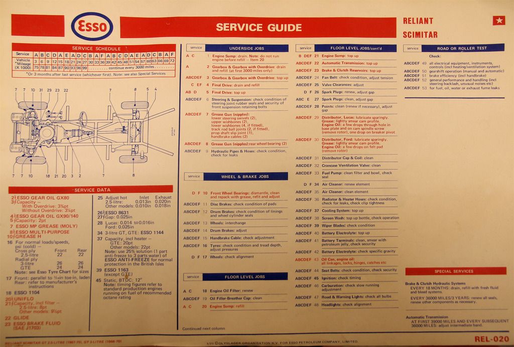

Hi All,
Could anyone tell me where all the grease points are on the Coupe? 1st time I've greased it (Not sure it's been done in a while!) I've found one on the steering rack, 1 on each side of the front suspension. Any more?
Cheers
Peter

If in doubt, read the instruction manual (Page 40). :mrgreen:

haha, sadly I'm missing one of those! Hopefully the link will prove useful. Thanks

From my own document archive, this V6 Coupe Esso Service Schedule might also be of some help?

At least grease the rear axle behind the brake back plates and the hand brake cable
