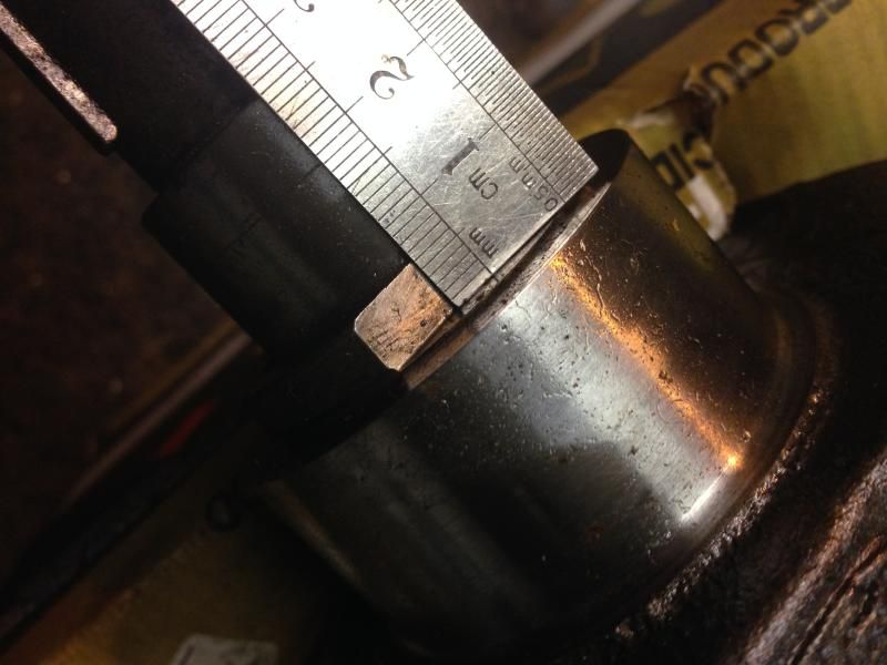

Re: CVH oil pump
Post by nickkeyser » Fri Jan 09, 2015 11:49 am
And an early crank nose;

Re: CVH oil pump
Post by nickkeyser » Fri Jan 09, 2015 11:51 am
Burton list the same front crank oil seal and gasket for both, so I believe the drive is the only difference. It's worth noting however that care is needed when aligning the earlier pump type.

Re: CVH oil pump
Post by nickkeyser » Fri Jan 09, 2015 12:20 pm
Yes, also looks like the surface of the drive face almost doubled on the revised pump, and there is noticeable wear on mine (see top pic of crank).
