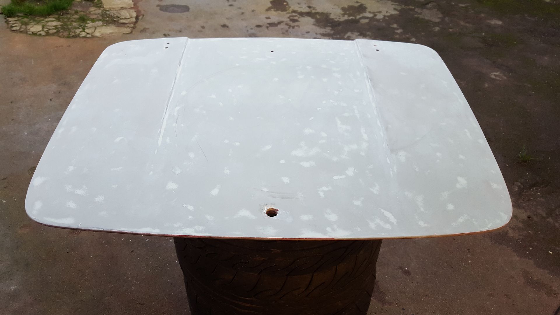

A little progress today. Both rear windows out, rear bumper had to be cut off due to seriously rusty mounts, rear lights removed, aerial removed and bonnet mostly sanded down

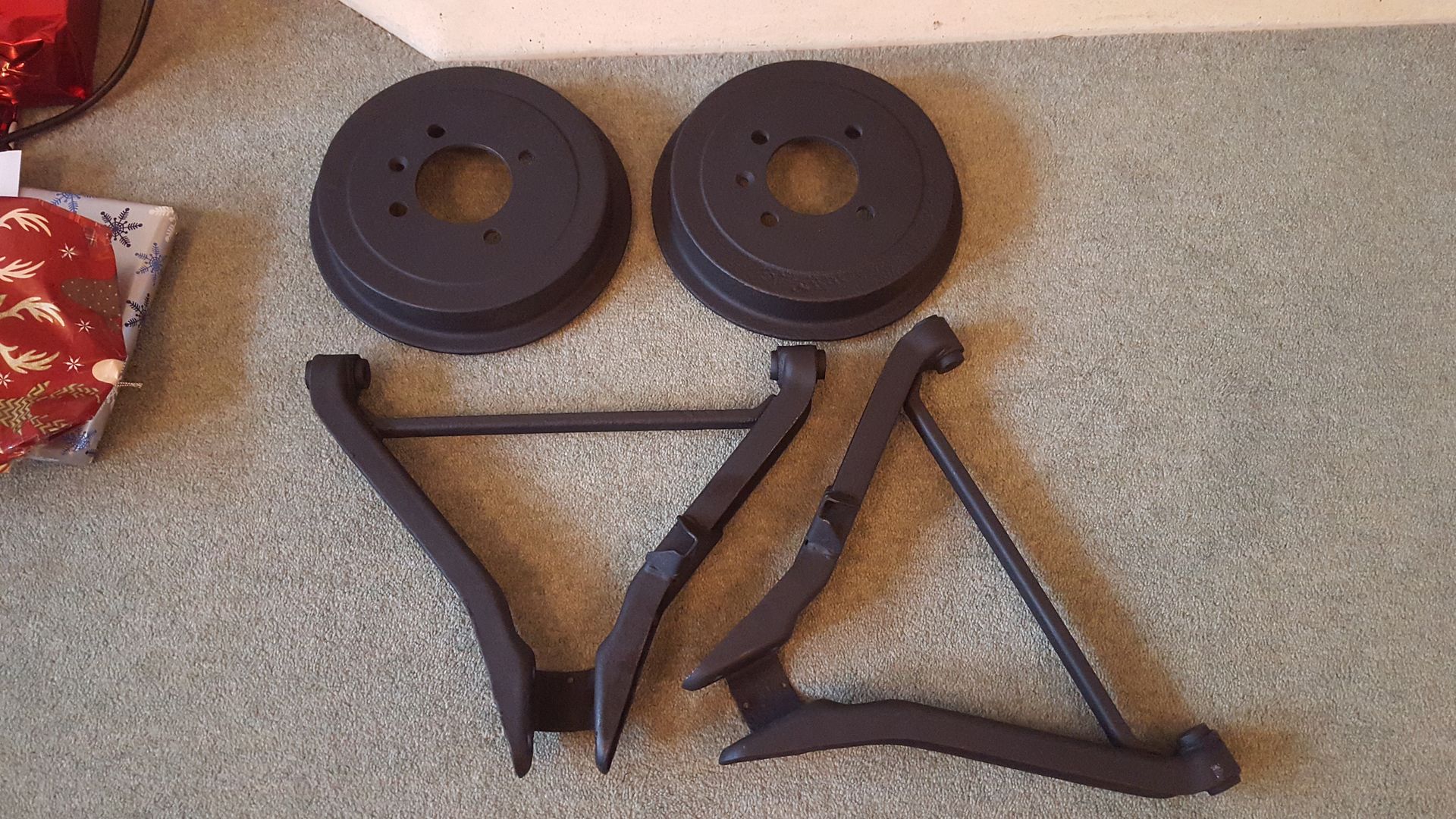

As for progress, all the front Suspenion has been pulled off, shot blasted and painted. I still need to do all the chassis around and behind it and I've had to buy 1 new upright and stub axle as the threads at the bottom of one of the uprights was non existent. The new cost was a little depressing but you can't find second hand ones so it's been ordered. I'm still waiting for the new trunnions too

I could have helped you out with the upright as I've still got a few spares knocking around from my Rebel days. Don't forget to ask in future :)
Posts: 5561
Re: Oaksey's Rebel
Post by Oaksey » Fri Dec 25, 2015 1:11 pm
Damn. I tried all triumph places and assumed there'd be no rebel ones around. Oh well, it's nice to get shiny things in the post :mrgreen:

I do have trunnions, wishbones and probably uprights here ;)
