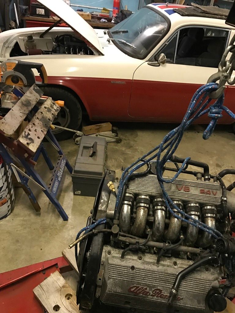

Not had a chance to investigate the axle problem yet but in the meantime this arrived:
This is a 3.0 version of the same engine, I believe they are rated at about 230bhp so with the right exhausts, mapping, intake etc I might see 230-250 if I just put it in. What I intend to do is to first build up a complete powertrain assembly similar to what I have now but maybe with some improvements, possibly also rebuild the engine and tune it a bit further. Then decide whether to put it in the Scimitar or something else......
