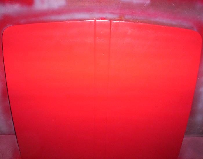

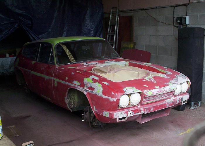

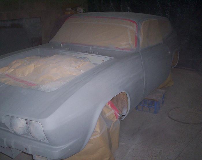

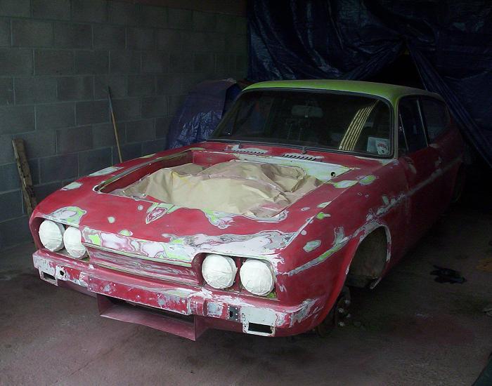

Back to the painting...
More sanding

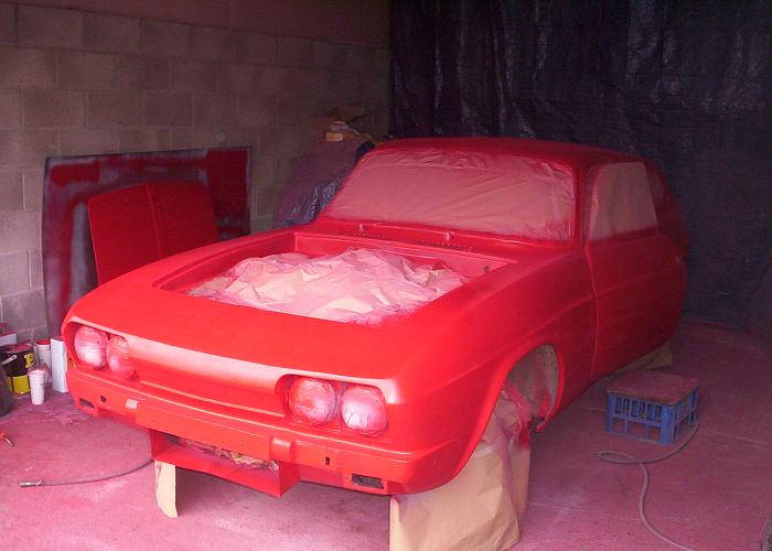

Lots of filler and many hours sanding I was happy enough, then complete disaster when I put the first coat of cellulose primer on as it reacted with one of the previous coats of paint. The roof was fine as I'd gone back through the previous coats but on the front, sides, doors, bonnet, etc, where I had only sanded the bads bits, there was lots of crazing in the primer. I don't have time to start again, so after reading about similar problems on the internet, I went to Halfords and bought 5 x 500ml aerosols of their grey primer (which is acrylic so seems to cover anything) and used up 4 of them to cover the crazing, which worked but obviously the crazing can be seen through the halfords primer
4 top coats of Radiant Red, some bits have come out shinier than others (it was difficult to see while spraying, I could have done with an extraction fan or two!)

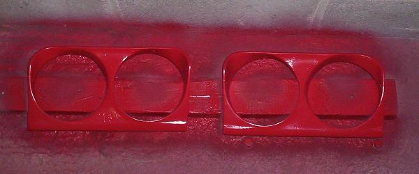

Did the headlight surrounds and bonnet as well
