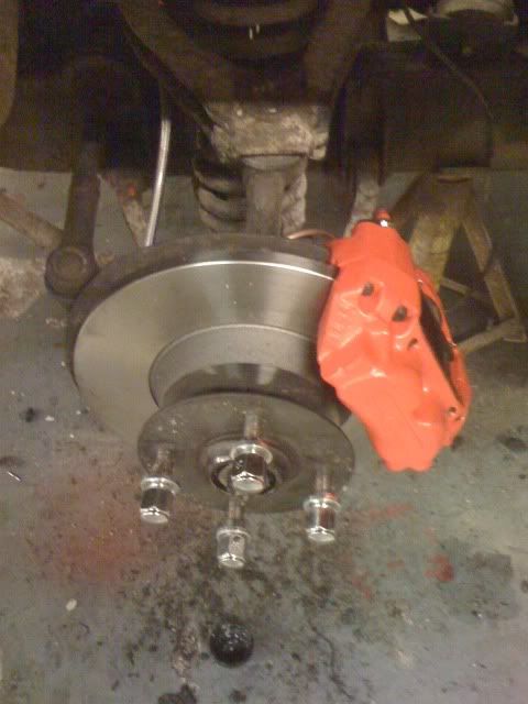

Got a few bits in the post from Walkers today, so finished off the front brakes (minus the hub/bearing caps because I kinda mullered those getting them off - must order some more). New calipers now fitted along with EBC pads, stub axles/bearings inspected, cleaned and regreased, copper lines and Goodridge hoses all fitted:
I was going to make a start sorting out the rears, but they'll have to wait for another evening. I need to order the springs that go between shoes, adjuster and cylinder anyhow, along with a couple of drum retaining screws. The drums have come out of their Deox-C soak a lot cleaner too!

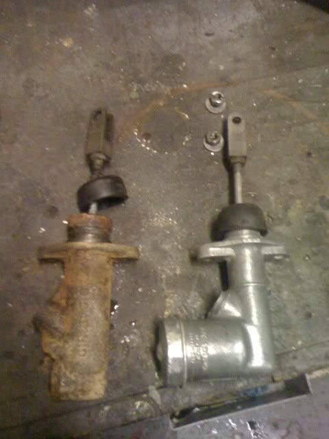

Work on the Scimitar will be stalling a bit over the next few weeks because I'm moving up to northern Scotland, but the drums have come up a treat with the Deox-C, and I've received all the parts. I haven't re-installed the rear brakes as I am running out of time, but the drums have been wirebrushed and refitted so the car can roll, and once up north I'll replace all the lines that I haven't so far. I also took the master cylinders off to clean and rebuild - after a good soak in Deox-C and a good wirebrushing, look what happens:
I took a pic of one 'done' and one 'before' to show the difference it makes; amazing really! I'll take them apart properly, clean them down and rebuild once I'm settled in - I guess I'll need to blow the crud out with some compressed air.

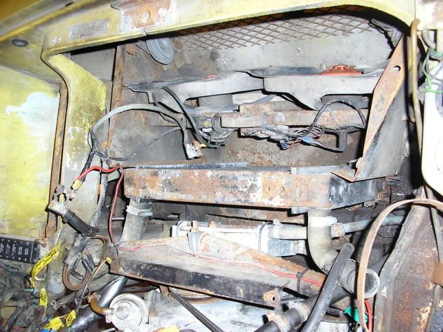

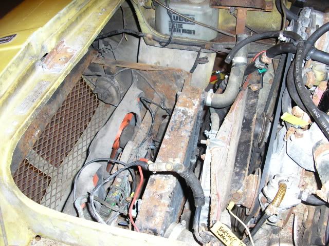

So, could somebody please explain the first line about the front bumper x-member support plate? My car had already had the spare wheel tray removed when I bought it, so I'm not too familiar with that part of the car. Pics of my car below if it helps:

You can just see the rear edge of the front bumper cross member support plate in the first photo. It sits on the top of the two rad side plates and has two largish studs which protrude through the bodywork to mount the bumpers on. The rad side plates have the horns mounted on them.

I think that the front bumper crossmember can stay on the body (then you don't have to fight with the overriders) - the support plates are the two side plates - they're bolted to the chassis at the bottom and the crossmember at the top.
