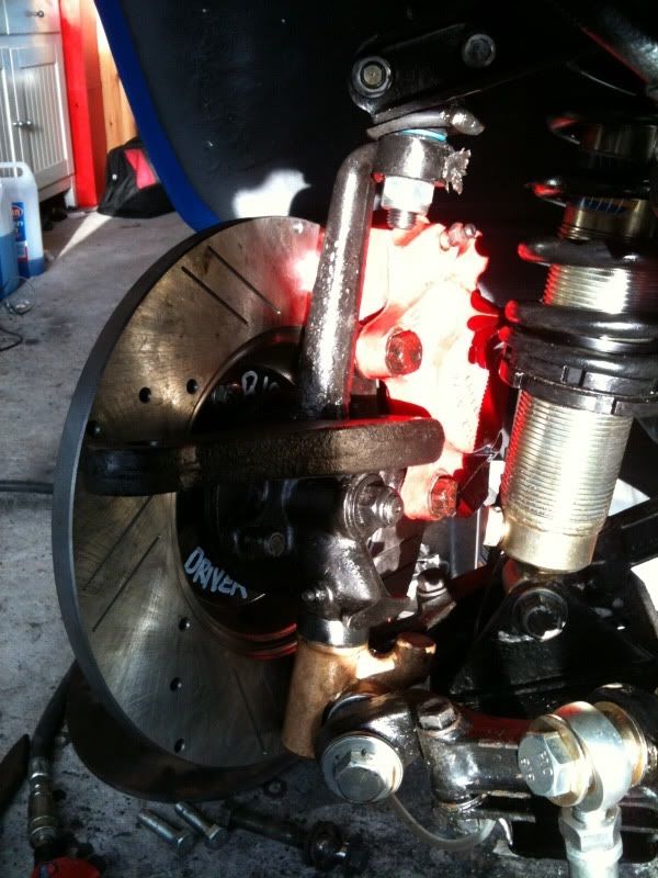

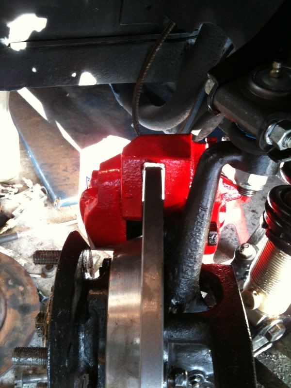

A couple more pictures of the TR6 disc fitting :-
This is just a trial fit. The observant will notice a lack of brake lines, dust shield and locking tabs.

Interesting. I have drilled & grooved TR6 discs - from Neil Revington - on my 5a: they fit round the Girling 3-pot calipers straight out of the box.

Nick_F wrote:Interesting. I have drilled & grooved TR6 discs - from Neil Revington - on my 5a: they fit round the Girling 3-pot calipers straight out of the box.
Hi Nick, the 5a discs are the same as TR6 so fit straight out of the box as you say. Unfortunately when it comes to SE6a onwards it's not so straight forward, the Lockheed discs have a smaller O/D but otherwise look identical. Hence the need to trim a bit off to get it to clear the caliper.
The other way of doing it would've been to use 5A Girling calipers. This would've needed an imperial to metric conversion on the brake pipe and maybe a bit of fiddling with the M12 bolts from the Lockheed system to get the Girling caliper into position. If I ever do the job again, I'll probably do it that way.

Good news ! Both sides of the front suspension are now fully rebuilt. Grooved & drilled discs fitted, calipers painted and new Goodridge hoses fitted.
I also fitted the home-brew ARB drop links.
This is the N/S after some wire brushing. The galvanising has stood up well, but I've given it a coat of black hammerite for cosmetic purposes.
Caliper cleaned and painted. New copper pipe fitted (it's much easier to do this on the bench than on the car) along with Goodridge hose. The bottom photo shows the small amount I had to file off the caliper tyo clear the domed area of the TR6 G&D disc. I also had to give the caliper another coat of paint after this bit of work :oops:
