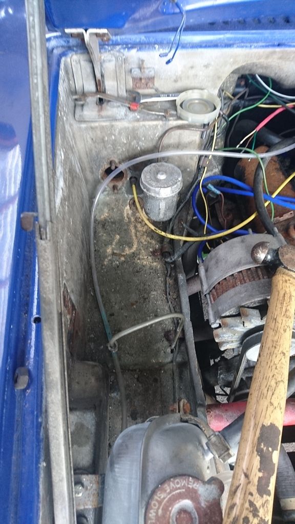

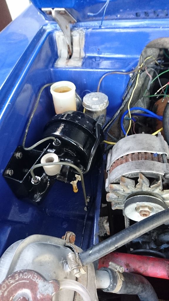

So the master cylinder and servo have been off and treated to a lick of paint, as has the body work underneath
Before
After

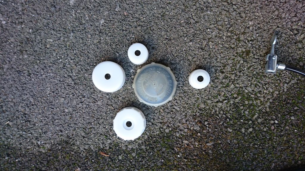

Now comes the problem. I was raring to go bleeding the brakes with the ezibleed I've just bought can anyone spot the problem with the kit.
Now does anyone have a spare master cylinder cap? I'm planning to 'adapt' mine to use with the ezibleed. I just want to check I can get a replacement before I do.

Yes, I can...
all the parts have got holes in.
:D
