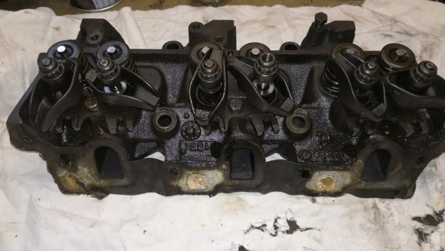

I do not have my engine at home but I recovered the cylinder heads to clean them. I take this opportunity to share what I discovered. It's amazing but I really feel that the seal of the intake manifold blocked the water holes. When I scratch the material I seem to be the same as the seal, with fibers. I let you look at the picture.
I have disassembled the valves and the seats are a little damaged on the exhaust valves, there is axial mouvement in the exhaust guides. We will see if a break in the seats will suffice. It will probably also be necessary to put valve guides, I do not know what is an acceptable tolerance.

Inlet gaskets again :roll:
They cause so much trouble and lead to overheating.
There should be No perceptible play in the valves.
The cost of refurbishing an engine is enormous, especially if your reconditioner cannot source the correct parts and has to resort to whatever is offered.
Point in question is Gasket sets, there are Very Good "Low Cost" kits out there, but they are not offered by the majority of factors.
I am sick of offering advice on what works and what does not.
I will stick to Direct emails from now on this subject :dh

I just bring the engine and heads to the machine shop for recontionning and the man told me that there is default on the adjustement for the exhaust valve. I have detected this also. In french we call that "il y a du jeu dans le guide", and google translate by this is a game in the guide, I don't know this is the term you use ...
So I asked me if I can find new oversized valves with a rod with larger diameter. I can see in the QRG bookparts it exists. If I have oversized rod valve, then I will have problem with the upper plate rod guide, because for standard rod valve, isn't it ?
The other solution is to mount new sleeves. And the man from the machine shop told me that this is not enought place
I have read in the forum that the liners K are not reliable. However this is another solution
Could you advise me please ?

I think usual the solution is to fit new valve guides in the head and ream the holes to size. A better expert will be along shortly to explain why your machine shop man says it isn't possible.

Done Dozens Eric, either Over size valve stems, which I told you I have.
OR the old guides are drilled out and new sleeves with the correct clearance hole.
I can have a look at how many OS stem valves I have left?.
They will not be bothered about the Upper plate, so don`t worry.
There are literally hundreds of sizes available.
