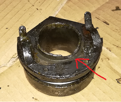

Last weekend I cleaned the gearbox. The clutch hub has suffered and the bearing is scratching a bit. Missing some metal parts on the hub. The set is to replace, curiously I have not managed to find a new piece identical.The hubs I saw seem less thick

I’m not sure where you’ll find a carrier for the release bearing - perhaps secondhand only?
The clutch release bearing is different to the Ford Capri/Granada item that you’ll find advertised for Scimitars - best to buy from Club traders.

Try Mark Wilson( gtcse8) I seem to remember he solved this problemfor somebody else quite recently.

Yes, there are (at least) two different release bearings which must match the whassname (diaphragm?) of the clutch.
Mark will know.

Yes, Mark supplied me with a carrier similar to your photo but without bits missing a few weeks ago. Try him.

Post by gtcse8 » Wed Sep 11, 2019 5:43 pm
Yes Chris
It is known as the Diaphragm, sometimes also known the Cover.
So you have the release bearing, clutch plate and diaphragm/cover in a kit.
Eric I have a few carriers and bearings left.
And a few Covers and plates for early IMPERIAL clutches, & a set for the Later METRIC type, 1974 onwards.
I Have replied to you.
