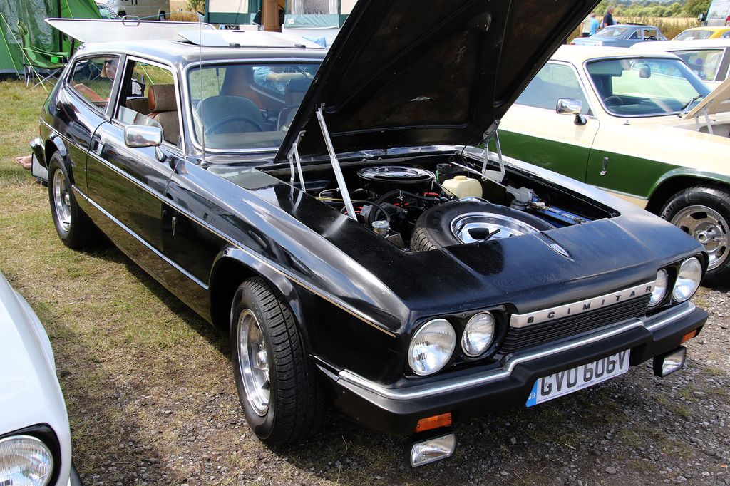

(PS... I don't suppose anyone got a decent pic of my car at Curborough? I took a few, and they're all crap! Would be even better if Steve's Black 6a next to it was in the shot too ;) )

Re pictures, how's this? (the car looked pretty shiny to me! :D )
I didn't realise the black one was Steve's car, I would have tried to get a closer look later if I'd known. When I took the photos I couldn't stop as I was rushing from the concours to the startline for the compie reunion :D

Roger - pics look great thank you ) The paintwork looked pretty good I think - as I spent some time going over it with a Meguiars clay bar, then Autoglym Super Resin Polish, then the Extra Gloss Stuff. I think the wheels could be better from looking at others, but I'm being a bit picky I guess.
