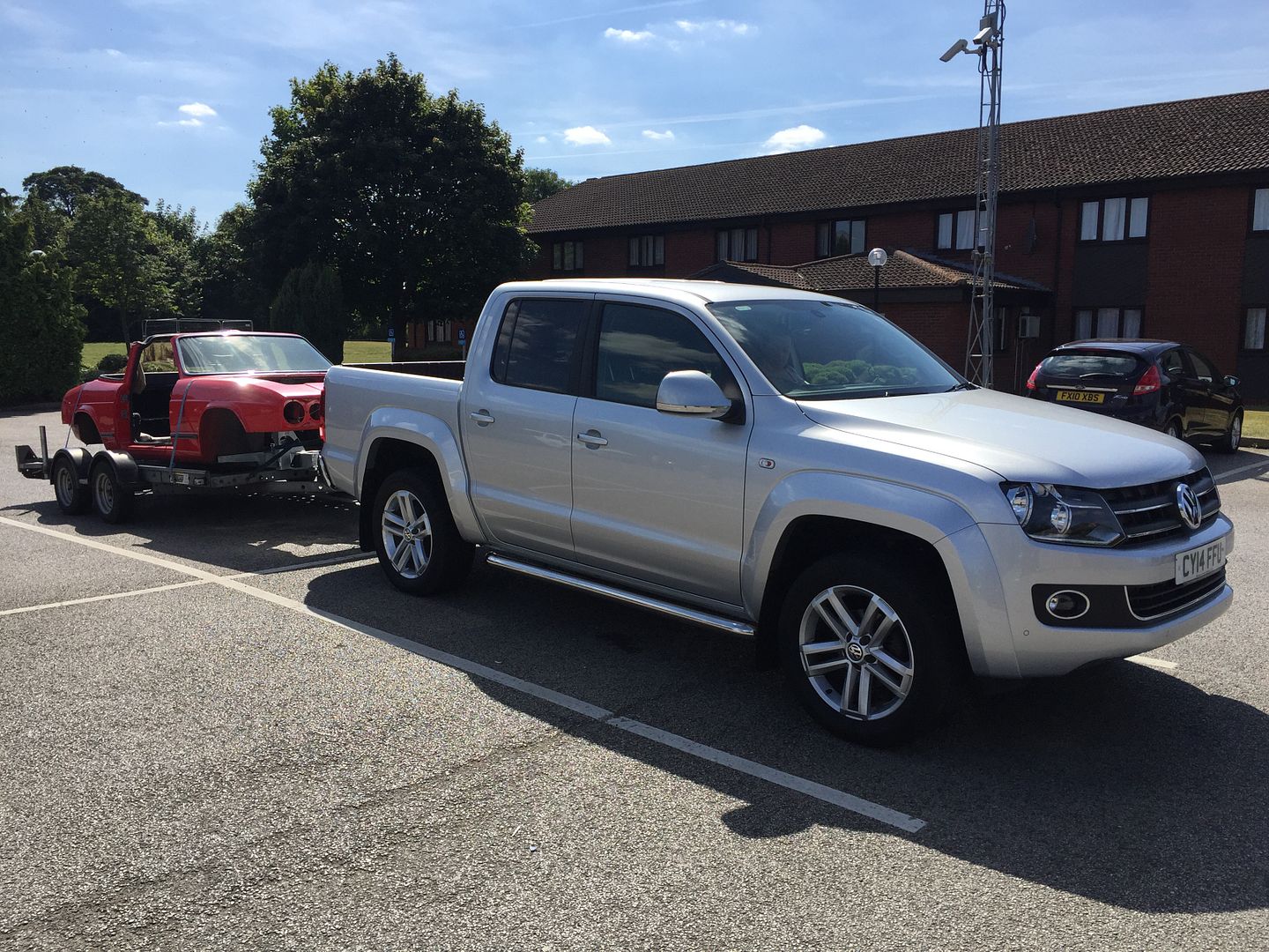

When Luke put a galv chassis and a GTC body with a V5 up for sale I couldn't resist buying it to realise a desire to build a GTC to my spec.. This was perfect as there's a lot of a complete car I don't want or would be replacing, so a deal was done and off I went to Lincolnshire to collect the car.. well chassis and body, which wasn't the easiest thing to lift onto the trailer :lol:
On the way back at services shot as per Coupe thread..
A week on and I've still not got it off the trailer as I need to clear two spaces for it first..
