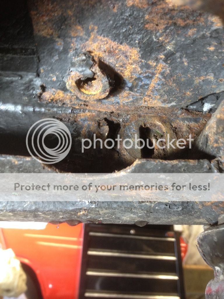

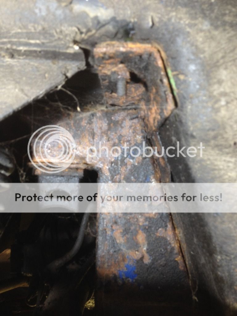

I had a nightmare getting the roll hoop bolts out, and it's actually very rusty in this area, even though it looked solid...it's not. In fact the more I scrape and bash it, the more I realise how a solid chassis actually isn't.

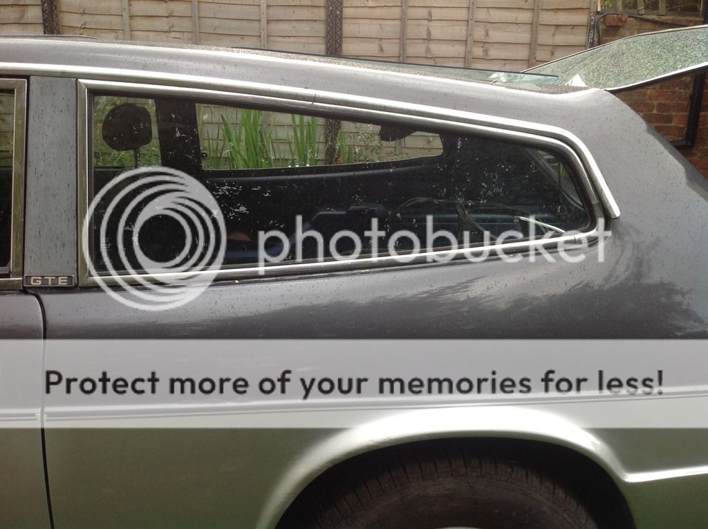

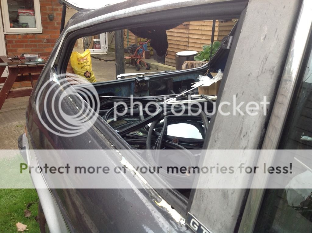

I'm really pleased with the outcome, and can't wait to start getting on with it. In the meantime, I've been stripping out the horrible damp carpet and trying to figure where the water gets in......and I found it. I suspected the rear windows were leaking last year as it's a common problem and there is silicone around the rubber in an attempt to seal it. I bought a new (and bloody expensive) pair new, and fitted one to the drivers side, it was hard to fit.......and it leaked.
As most will know, the leak comes from the water finding its way around the glass, running down to the bottom corner, behind the trim and the reappearing at the seatbelt mount where it soaks the carpet, and then rots the seatbelt and chassis. Nice.
I really wanted to sort this problem and came up with an idea.

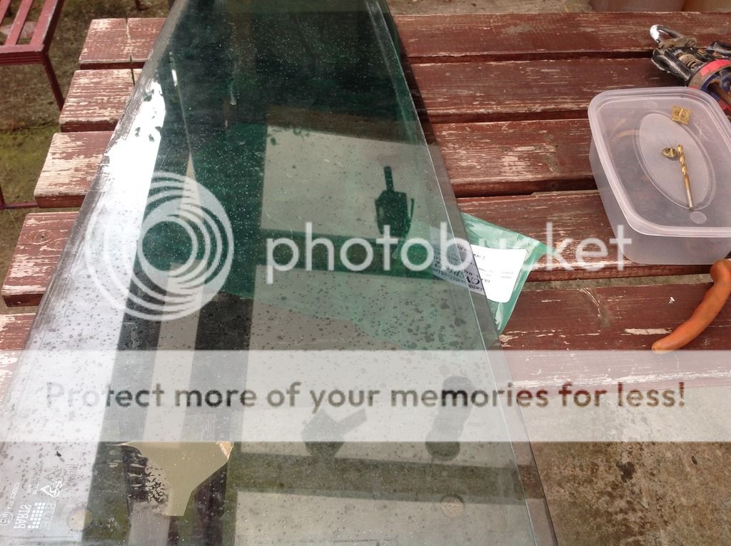

How about doing away with the retaining rubber completely and mounting a rubber around the edge of the aperture like the door has, and then add hinges as a lot of other cars have? The glass is flat, so it's not difficult to get remade to a better size, and I have a friend with an excellent contact with a glass manufacturer. A trip to the breakers got me a selection of hinges and openers, of which ones from a ford ka seemed ok for the job. I made a template from hardboard with holes in the relevant places and sent it off to be duplicated in (tinted) glass.
Rubber around the edge..
Old glass on top of the new....

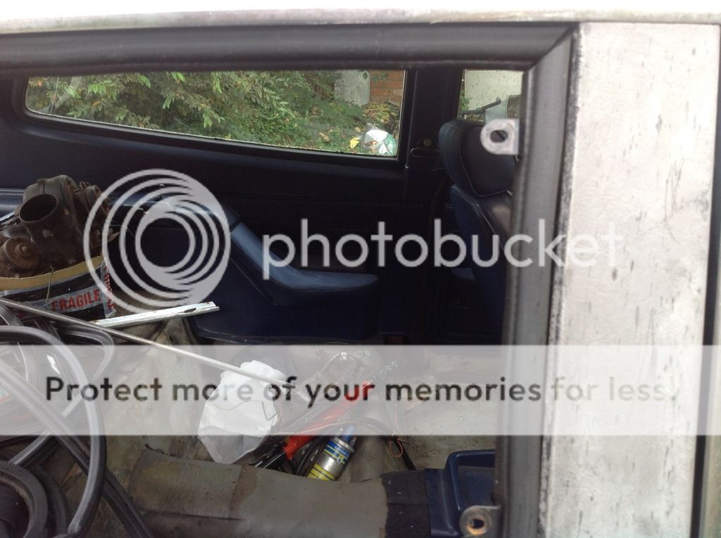

The new glass fitted.....

The new glass is exactly the same outside diameter of the stainless trim, and my original plan was to trim the lip from the back of the trim and then use screen adhesive to stick it on, which would make it look original and cover the rubber seal area, but now I'm not so sure?
I am now thinking of getting new front windows made the same and spraying the door frame for a cleaner look? What are your opinions?
After a huge downpour lone night last week I was excited and rushed out to inspect the pool of water.........original sealed side- wet, New opening window? Dry!
I have ordered BMW e46 openers as they are electric and sort of on a remote cable, so am hoping to be able to operate both on a switch.......watch this space!
