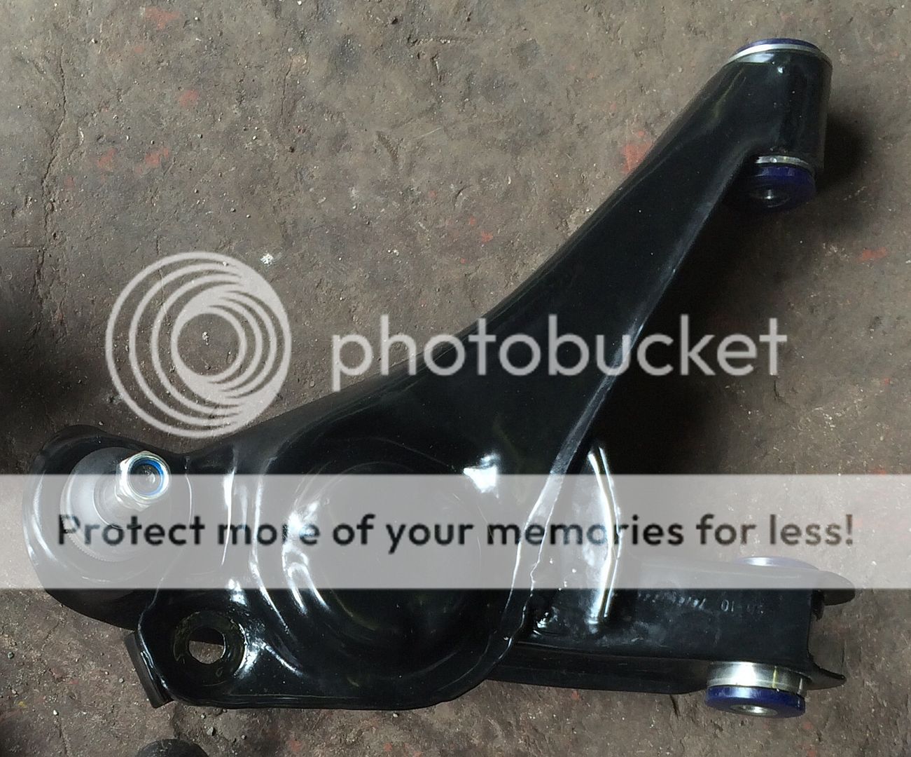

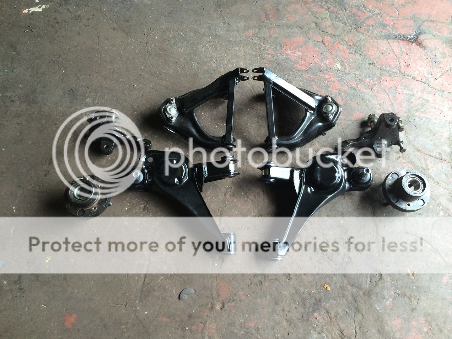

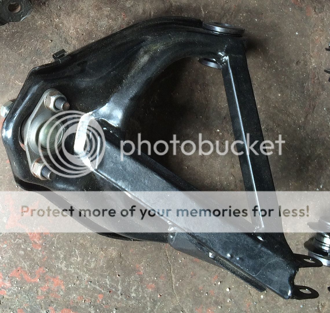

Just a few photos of the suspension refurb progress.
The upper wishbones now have their new ball joints & poly bushes.
The lower wishbones also have new ball joints & poly bushes.
The hubs have been split, painted, longer studs added and new bushes pushed in.
All that's left to do is to add the engineered vented discs before they are pushed back together again.

Well another week passed and another Curborough has been missed but on the positive side HHH now has it's newly upgraded front suspension on.
Just to re-cap
Top wishbones removed, strengthened added, blasted, powder-coated, poly bushed & new top ball joint fitted.
Upright removed, hub split, solid disc removed, hub & upright painted in thinned hamerite, vented disc fitted, new bearings fitted.
Lower wishbones removed, blasted, powder-coated, poly bushed & new lower ball joint fitted.
Front anti-roll bar removed, bar & brackets blasted & powder-coated, poly bushes added to ARB brackets & drop-links.
It's all been re-assembled but I couldn't face putting the 14" springs that it came with back in. It has always looked like it sat to high so I've used the old race springs from the SST but will a seat spring to raise the height a little and to kill the road noise a bit.

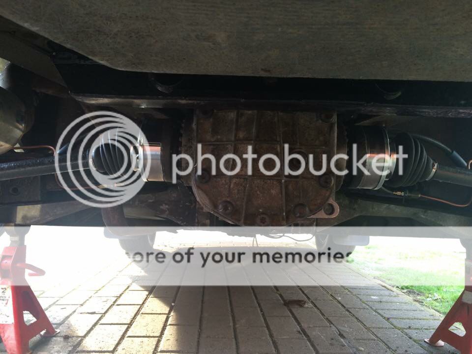

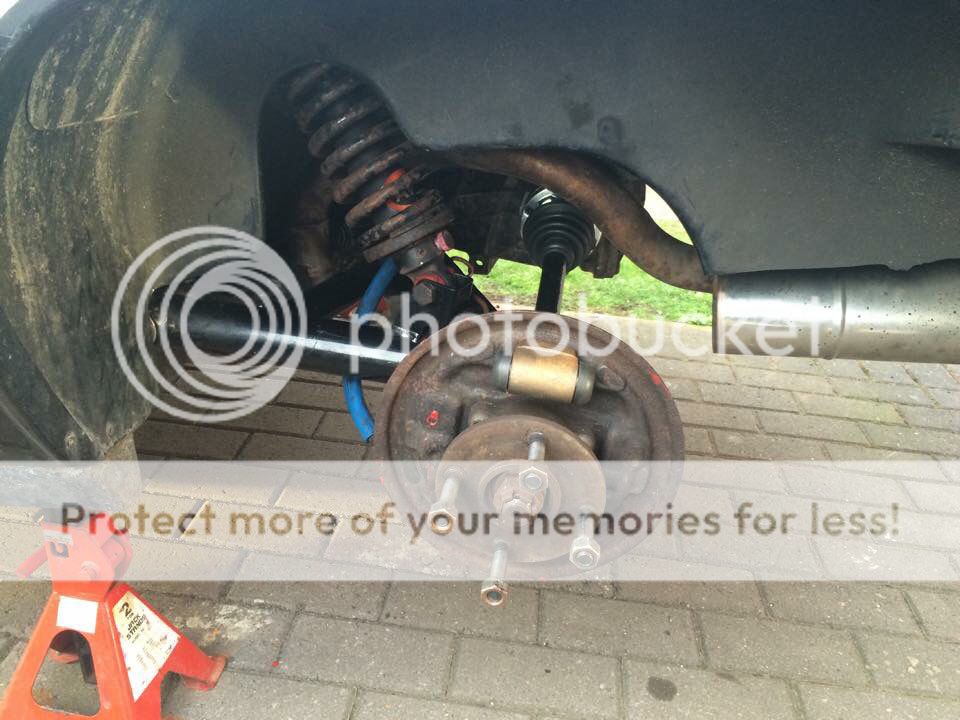

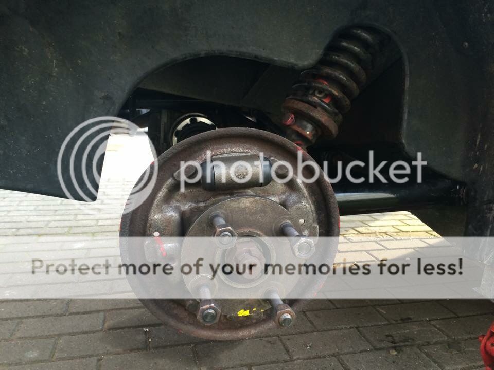

I have at last fitted the rear suspension and the LSD. The strengthened trailing arms were fitted with poly bushes, freshly painted back plates with larger wheel cylinders and new copper hard pipes. The trailing arms were bolted up and stainless steel flexi pipes fitted.
The drive shafts where stripped of the in-board tri-lobe cv joints, painted and then new lobro cv joints added to mate up to the flanged outputs of the LSD.
Yes, the very rare splined output LSD turned out to be a flanged output LSD without the output flanges - the joy of e-bay! Luckily a mate from sprinting had a couple left over from his days of blowing up 7" LSD's with a mental Cossie Sierra.
The diff was stripped and a drain hole tapped in the base to accept a spare magnetic plug. New seals were fitted and the newly rebuild diff was installed in the powder-coated diff cradle and fitted up to the drive shafts. Once all bolted up the cradle was bolted up to the chassis.
It's still leaves a fair list

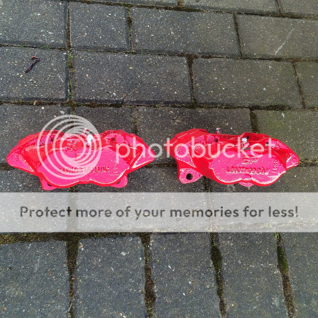

So the result of the pm's with Dad have had the result of moving the car on a bit further :smile:

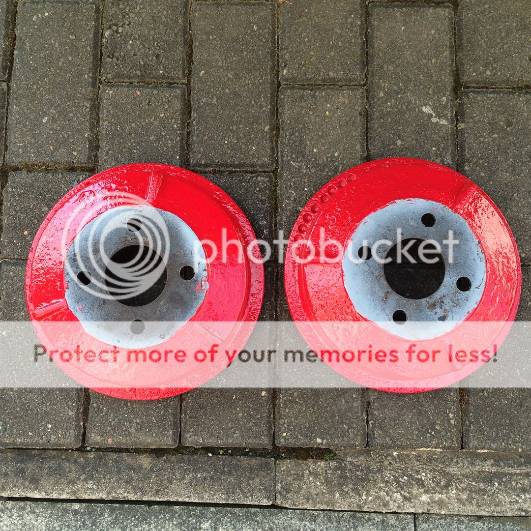

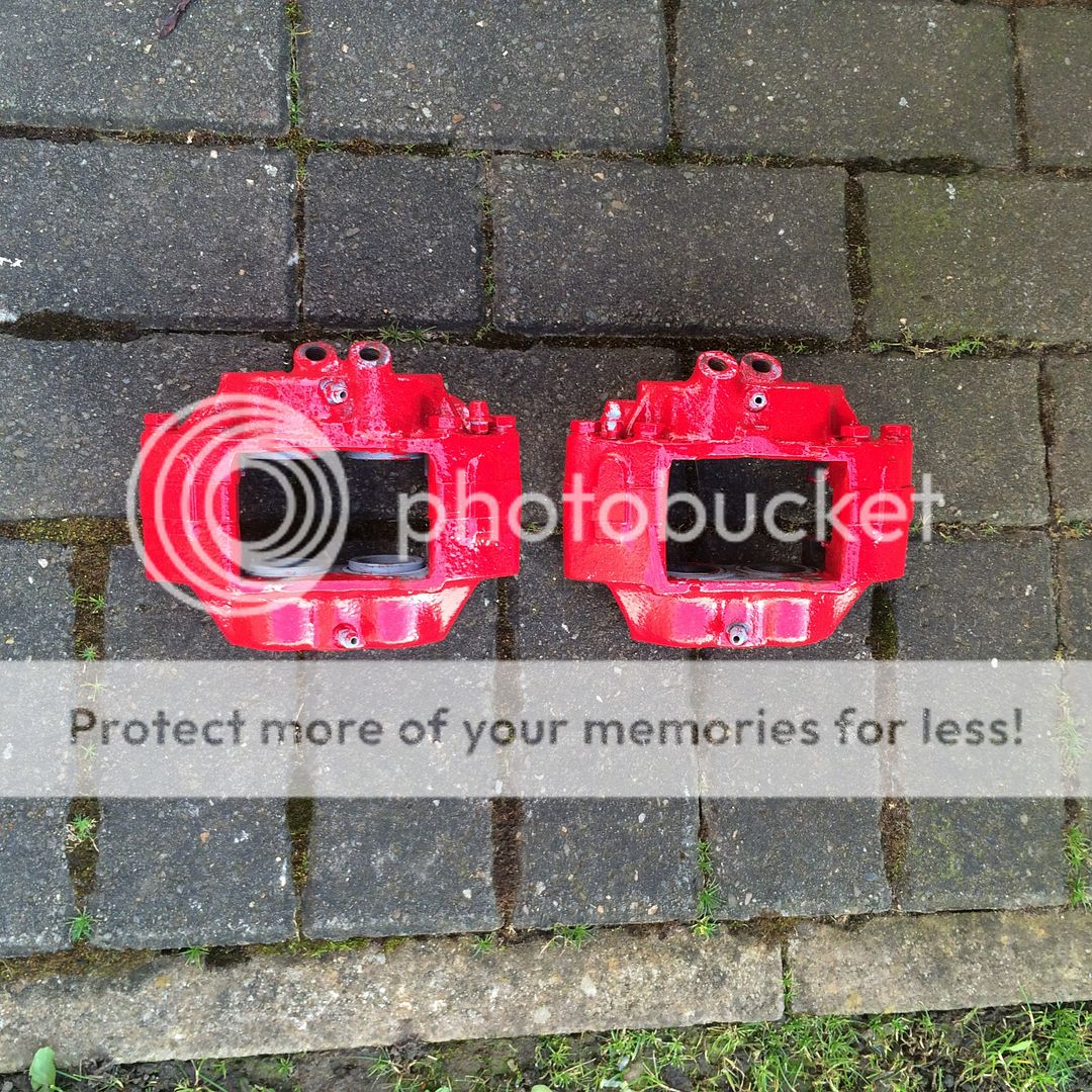

The eBay spacers I purchased weren't thick enough to make the callipers fit with the machined vented discs so I returned to the method used on the original upgrade I did on the SST.
Just to recap, I want vented discs to tackle overheating, that I've had boil the brake fluid before, but I don't want or need bigger brakes, as the braking effect is enough for the weight/power of this hot road car package.
So I sent the spacers to Dad and asked him to make them out of some thicker material. He has yet again come up trumps and the spacers are now installed with new o-rings & longer bolts. To ensure they look the part as well I finished them off with some paint, red of course:lol:
And if you've got red front callipers, it don't look right unless you've got red rear drums!
Now I've got to fit them & the new brake pipes!

Oooo nice shiny red calipers ! :D
Nice idea spacing the original calipers. Was using two lots of spacers an option ? Also what vehicle were the discs originally for ? I can't see it in the thread.
