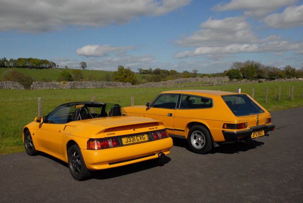

On the May Bank Holiday, one of my friends brought his Lotus Elan (M100) up for the day, and we went for a 100 mile blast around Dumfries and Galloway. It was fascinating to draw comparisons between the two cars, which approach fibreglass motoring from different perspectives.

The car looks great, and it's in lovely surroundings up there, too. Great photographs! :D Also the Lotus makes a good match, colour-wise :)

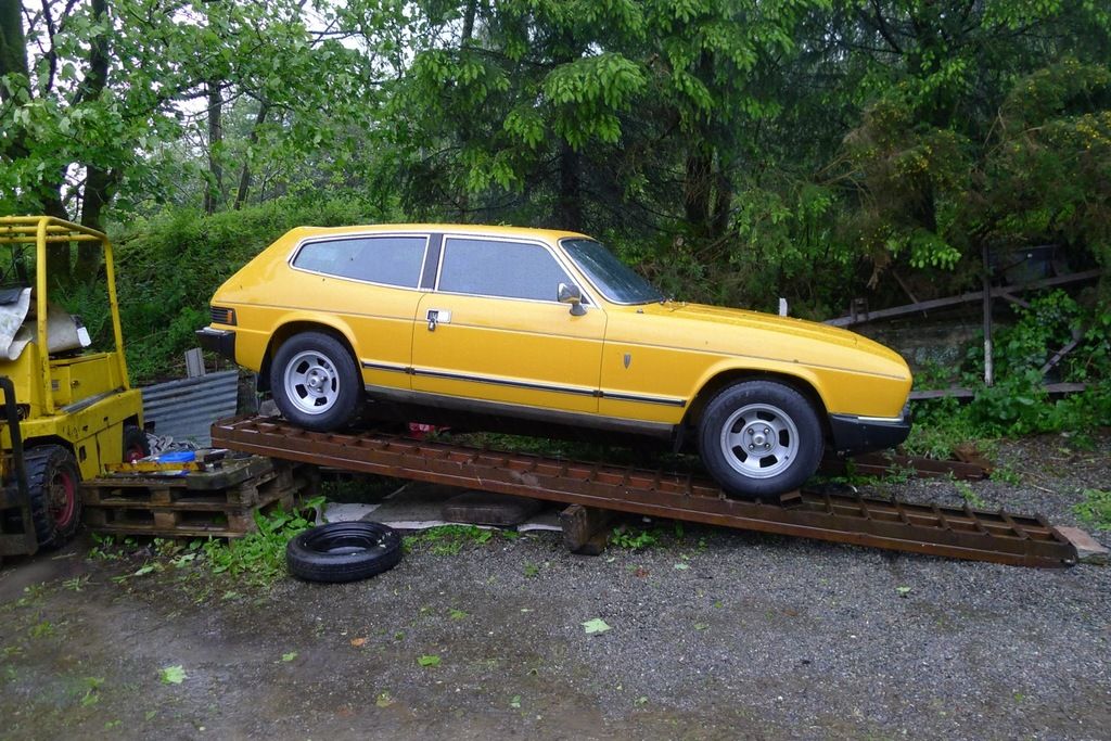

That's an interesting set of ramps! :lol:
FrazzleTC
Posts: 218
Joined: Thu Mar 27, 2014 11:22 am
Location: Staffordshire
Re: 1979 Scimitar SE6A in daily use
Post by FrazzleTC » Tue Jun 09, 2015 1:36 pm
Thanks Roger! I always take a camera out with me, in case I see a photo opportunity.
The ramps are at my friend's yard where I work on my cars, and store a couple of them. Not ideal, but they are useful.

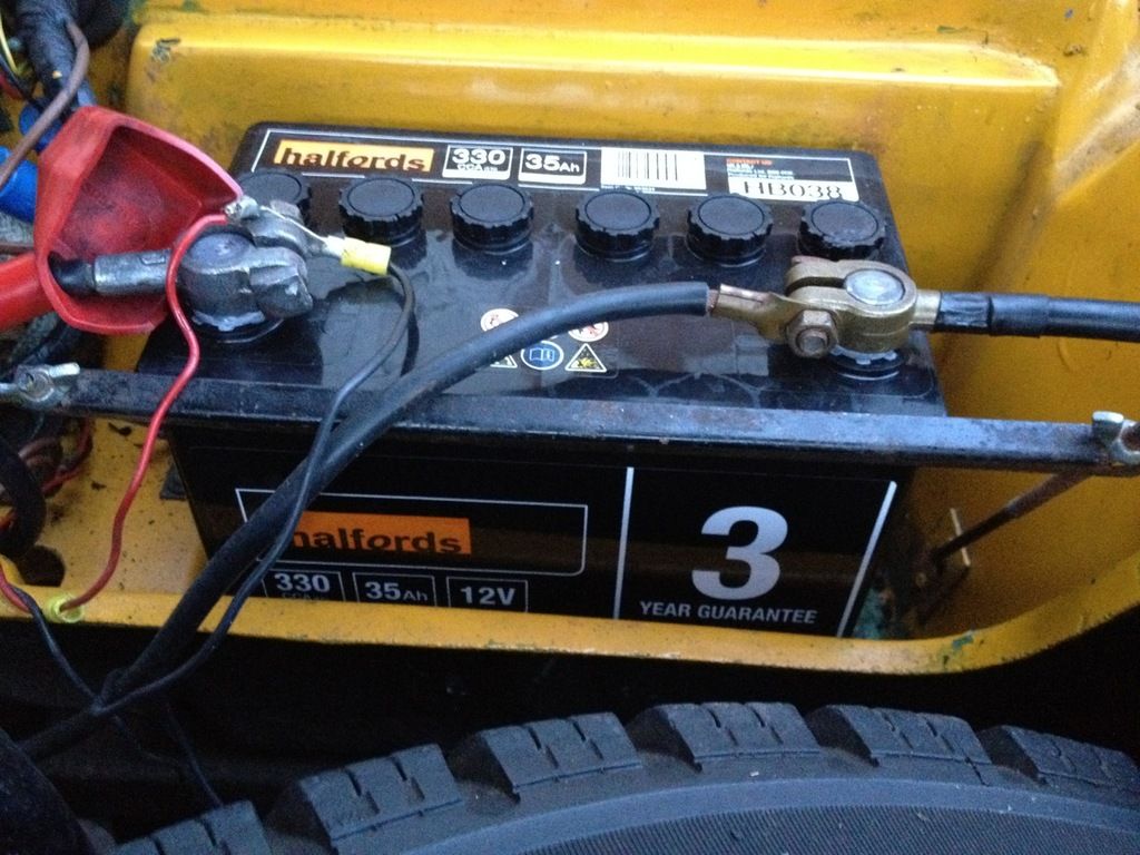

This year, in the last two weeks, I've spent a bit of time on maintenance. Unfortunately, the battery which was fairly new when I bought the car became utterly useless latterly. As a result, I nipped into Halfords, and bought one of their range, for £31 with trade discount. This gave me instant starting, and the car has never failed to start since. However, just a day after fitting the new battery, I slowed to let a car out, and the pedal went soft, so as I'd only travelled about a mile, I turned around, and headed home. When I had a look around the car, there was no evidence of there being any brake fluid leaks at the wheels. So, attentions turned to under the bonnet, and the culprit was identified as a faulty master cylinder. As some of you might well have seen, I ended up buying one from Corky, and it is excellent. Fitting was fairly straightforward, though unfortunately, I broke a bleed screw, on one of the rear wheel cylinders. However, all was soon sorted, brakes bled, and since then, it has very decent brakes again.

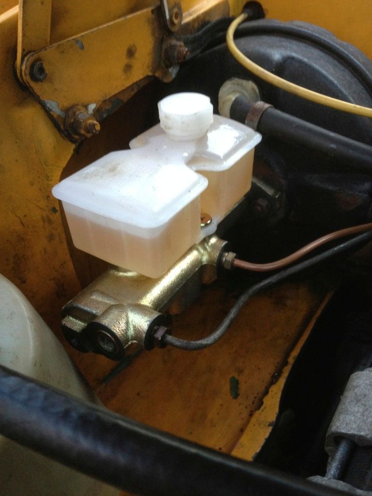

Glad you got the brake problem sorted. Did you wire up the brake failure switch ?

Post by FrazzleTC » Wed Mar 02, 2016 5:34 pm
I haven't wired it up as yet, but it's something I'll be doing in due course, as the onus was on getting the car back on the road as quickly as possible, in this instance. :)

Post by Corky » Wed Mar 02, 2016 7:14 pm
When you do, you'll need to cut off the original plug from your wiring loom. You'll be left with two wires. Pare back the insulation, twist the cores together and fit a female spade crimp.
