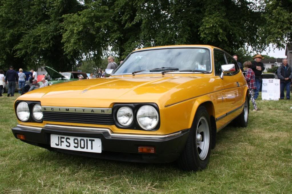

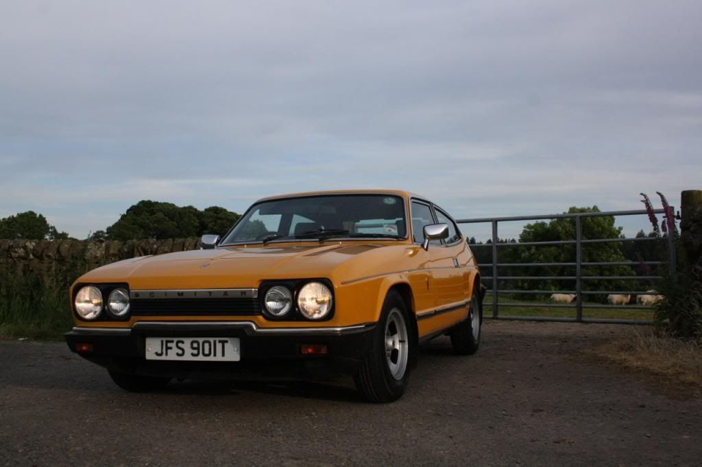

Since the last update, I've been using the car for commuting to and from work, and it's been very pleasant indeed. In the last two and a half weeks, I've covered just over 1000 miles, which seems to be more than the car has done since the early 2000s, as there are no MOTs for the car online, until 2012.
My replacement of various parts continued, with a new ballast being fitted, the handbrake being adjusted, again, but, more significantly, I finally worked out why the car was so awkward when it was warm, which was as a result of the mixture being far too lean. The timing has also been advanced a little, which has, again, improved matters.
Prior to solving the poor running when hot, I took the car down to Barbon Hillclimb, as a spectator, and then went a tour around the area, before staying in the Lakes overnight, and doing some more driving there on the Sunday, with a couple of friends. As long as I wasn't queuing, or travelling very slowly, the car went very well indeed, and I really realised how pleased I was, overall, with the Scimitar as a package. My friends, who all have classics, all got runs in it, and one or two are now thinking they'll buy one, at some point, which is good news. Fuel and oil consumption were very reasonable, and I didn't feel exhausted, despite covering 350-400 miles in a weekend.
Since then, I've used the car for daily duties, including commuting, and, I've finally got it running the way I want it. There are a few jobs left to do, including sorting the passenger side electric window, thoroughly waxoyling the chassis, and, also, I need to investigate a very very slight rumble, which I think could be the beginning of a failing UJ on the propshaft, but, I'll see how it develops before tackling it. I've now put grease into most of the grease points. I also want to check the diff oil level, and the gearbox level, before long. I reckon I'll do a full service in another 1500 miles, and see how things stand, after that. I discovered that there were blows from the manifolds, but, since i need the car on the road, at the moment, I've 'sorted' these with exhaust paste, but, will get the manifolds off, and welded properly, when I've got more time. Finally, I've sent off a V888 form, as I really would like to find out more about the car's past. Does anyone know the car, or remember seeing it at events in the past? It's definitely belonged to a Scimitar club member, in the past.
Overall, I'm thoroughly enjoying Scimitar ownership, and last night, decided to join the RSSOC, as I reckon that it sounds well worth it!
Here are some photos of the car in use, to show where it's been! :D

Looks good, nice photos, and welcome to the club! :D

I took it to a show, on Sunday, where it got a few comments. Drove very well on the way there and back, making brisk progress, as always.
