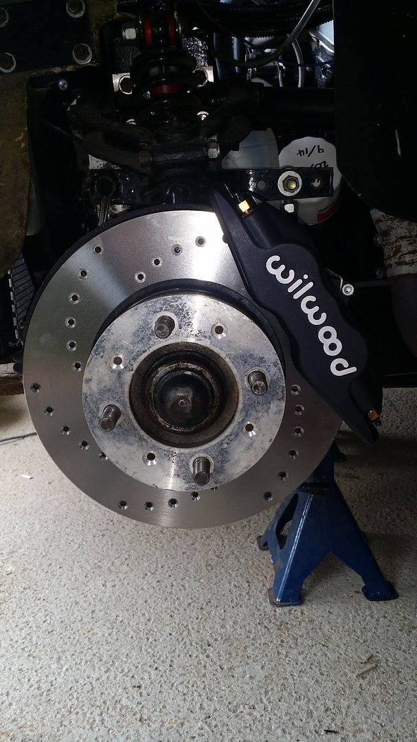

And some discs from Rally design.
Cliff Dowle
1971 SE5 Competition Car!

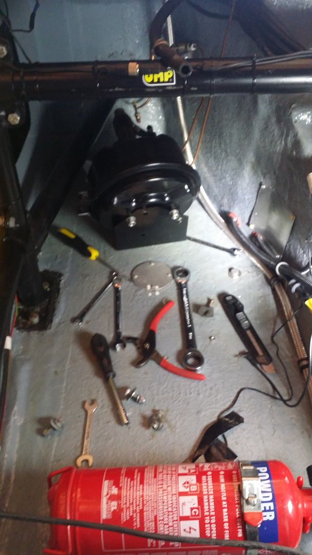

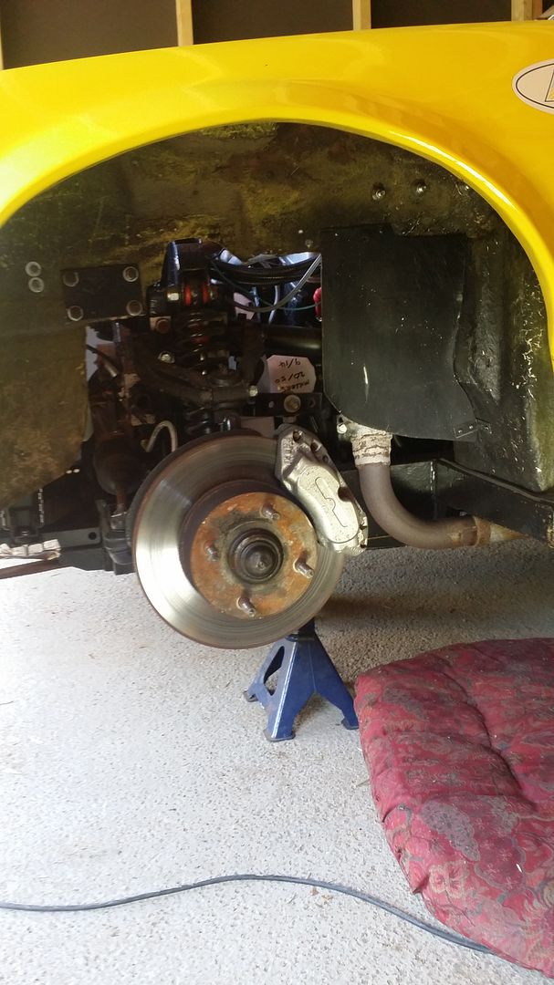

Well it was time I did some work on the car.I've not really touched it since Shelsley Walsh last year and from what I can remember from the event the brakes were a bit sticky. Im pretty sure this was down to the master cylinder. I had planned to change the discs and Calipers anyway so would be changing the master cylinder at the same time. Plus as an extra bit of weight saving I could remove the servo at the same time.
So out came the servo, old calipers and discs removed. I was surprised how much the old calipers weighed or how little the superlights weighed in comparison.
Due to no longer using the servo (which was located in the passenger footwell) I had to make up a new brake line from the master cylinder & also made some that go between the flexi's and the calipers. Turns out I really enjoy making brake lines! :D
All I have to do now is bleed the system and hope my brake lines don't leak!! :shock:

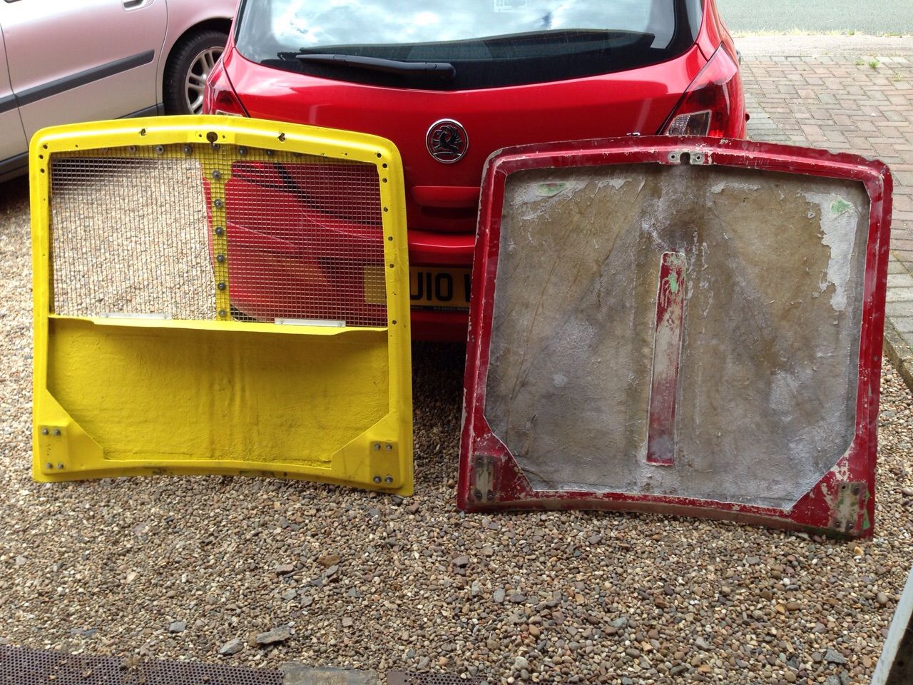

Also while I had the bonnet off I started prepping the new one, although I wont be fitting it till later in the year, still got to prep it for paint and then get it painted.

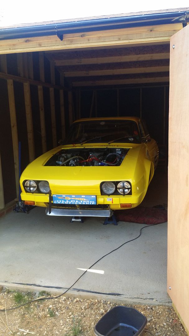

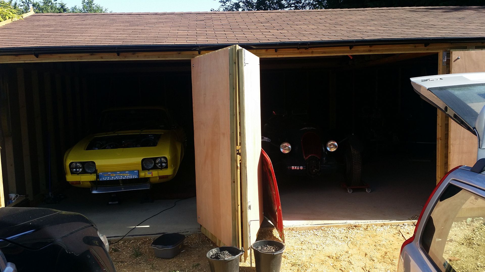

...What is the stablemate lurking in the shadows.......?
The SE5 looks fantastic, by the way.........
