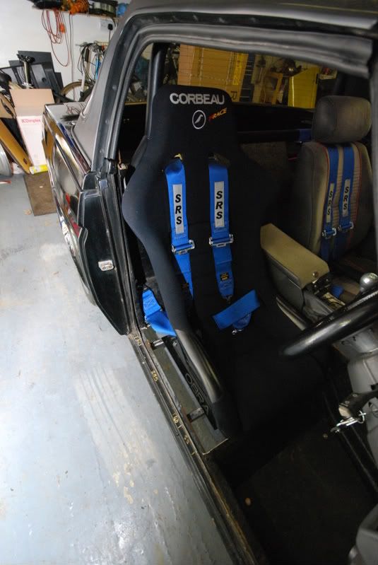

i then got it running well enough to get an MOT on it, and used it for a few months continueing the development, i have stripped it out a bit, fitted a bucket seat and harness, and started loweing the floor.
it currently stands at this:
hopefully i will get around to glassing the floor back in soon!

Update Time; layed up some section to fill in the gaps created by lowering the floor:
and all glassed up:
and seat in:
much much better to drive! well worth it!

Raz987 - I found the fibreglassing a bit daunting at first, and kept putting it off, but once you get bit of the original floor bolted in, the front and back are easy, and from there its just a bit time consuming and messy. it did take me quite some time to get around to doing it all though. (chopped it out in about november! then coursework, christmas, etc got in the way, and my mojo took a bit of a knock)

Have you gone for the full cage?? If so will the door bar clear the drivers seat (currently looking at a bucket into mine & i'll have to "relieve" a smidge off the side of the seat to get the door bar in with the seat dropped).

dropping the bor through the floor is a good plan! get the weight down a bit too. mine has two rather heavy duty stainless straps running front to back, and up each end of the tub. probably rather over the top but dont want the battery dropping out, however unlikly! these would need modifying to drop the battery.
i have gone for a full cage, dont know how well it will clear the door bar, finger crossed it wont need to much releiving. the 'wing' of the seat is very close to the door, the door card would have needed a chunk out of it if it was fitted. hmmm. got me thinking now.
theres a second set of holes in my rails, about an inch closer to the tunnel, but due to the little upstand at the side of the tunnel i dont think there will be room to fit the side mounts. slightly over looked that one.
