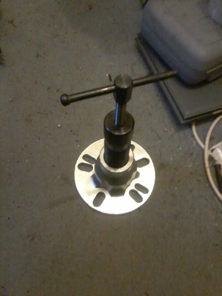

Post by PlasticMan » Tue Aug 12, 2014 7:57 pm
It has arrived....
I will probably have to wait till the weekend to give this a whirl, unless I get a quiet evening. The best bit is that it came with a sealey tool catologue, who doesn't enjoy browsing tools?
Coco La Blanc
Re: Stripped down to the bare bones...... (SE6A in Hants)
Post by Coco La Blanc » Tue Aug 12, 2014 8:07 pm
I will be interested how it performs ? :| :roll: :wink:

OK, in use, you need to retract the piston as far as possible, also unwind the cylinnder until it will fit flush with the hub. I used a wheel spacer to help. Large washers and half inch UNF plain nuts bolt it up tight. Wind in the cylinder until it contacts and then start winding the piston in. Get it up tight, have a cup of tea and if it hasn't released, give it a couple of sharp taps with a Birmingham screwdriver. You should be rewarded with a loud bang. It has never failed me, where the so called professionals have.

Remember to stand away from the hub. If you have forgotten to refit the axle nut, it will come off with enough force to seriously remodel your features.

Post by Lukeyboy46 » Tue Aug 12, 2014 9:53 pm
AJL's hub puller Worked for me 4 times recently, good piece of kit!
But yep, remember that hub nut. It's a loud bang.
