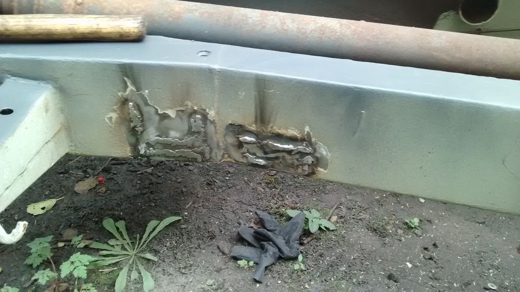

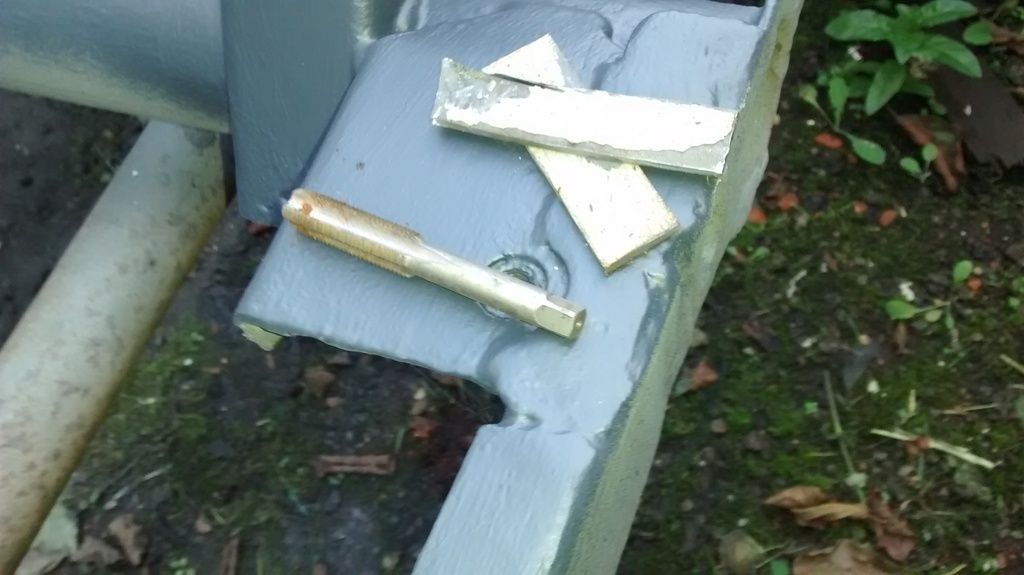

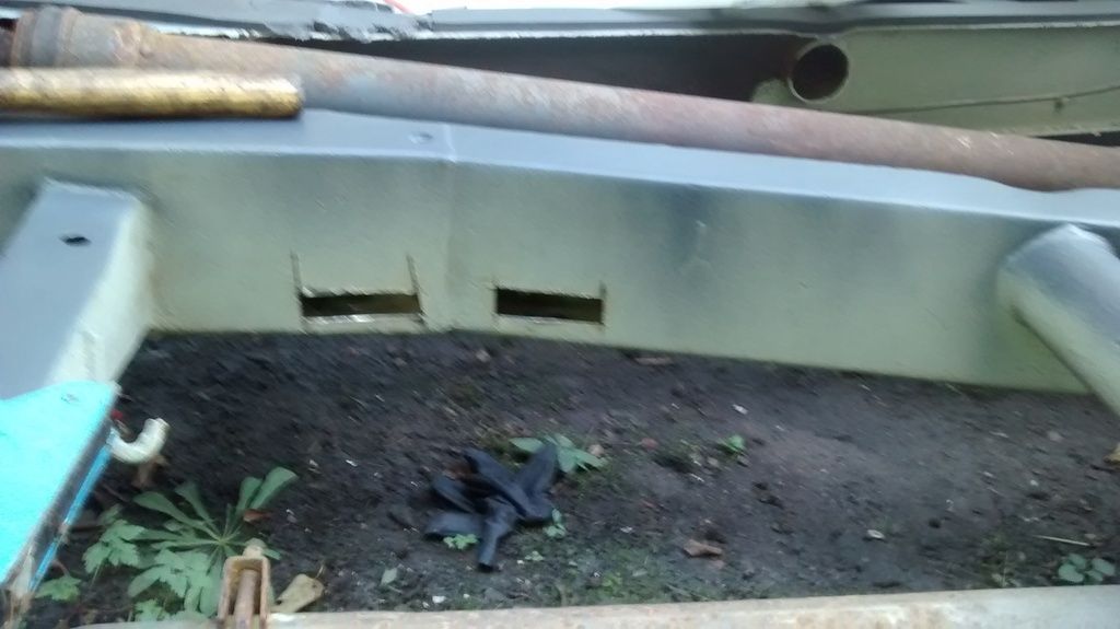

I've had a few days off work, so I have been beavering away in my shed welding up stands to put the body on for the reunion. I have also been doing my checks trying to work out if I have forgotten anything, then I realised there are captive threads in the chassis that I have painted over.
The tap and dye set was hoiked out of its hiding place and I set about tapping the holes, annoyingly I managed to lose a tap into the chassis as the tap wrench decided to let go! I checked underneath and realised this was box section, the tap would be rattling around inside the chassis forevermore, it would probably drive me mad so drastic action was called for...
Out came the grinder.. (sorry about the blurryness!)
If you are wondering why two holes? The first hole leads to a second skin, so I had to cut another and fish the tap out.
The culprit..
Crackle buzzz crackle...
Back on track then!
