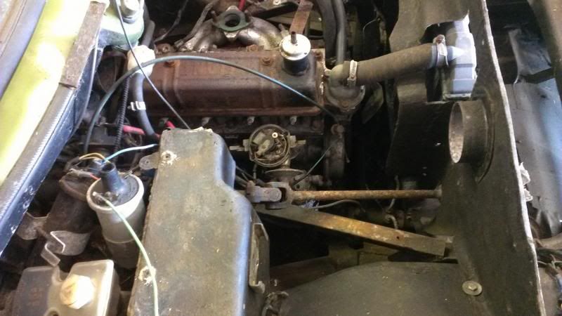

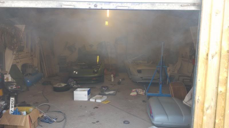

I'll have to investigate a little further tomorrow, but as 2 of the pics will show, it smokes a bit! I managed to get a carb together out of 3 I had in bits, and did similar with the dizzy...and whilst it runs (roughly) it sounds sweet. But the smoke was horrendous, compression isnt good on No.1, and theres oil dripping from the exhaust (Which it did from the outset, from a hole. I presume it was already in there). Not having the capabilities to rebuild an engine, and presuming time hasnt been kind to it as I suspect, then it looks like Im saving and looking for another. I'll get it outside tomorrow and run it a bit longer though. Any help or suggestions would be good!

Could it just be stuck rings from the layup?

not bad for a first day ;-) I put some oil on the pistons via the inlet manifold in the past... that explainst be the smoke. :D

I had masses of oil in my exhaust, which caused masses of smoke when the car first arrived. (The compression figues werent great either)
After running it a bit and changing the valve stem oil seals, all is much better :)

Well Done! Your workshop is starting to look like one of those original factory shots! :D

:lol: Theres even a spare nosecone and screen surround in the pic....in fact, parts of 3 Ciphers in there!

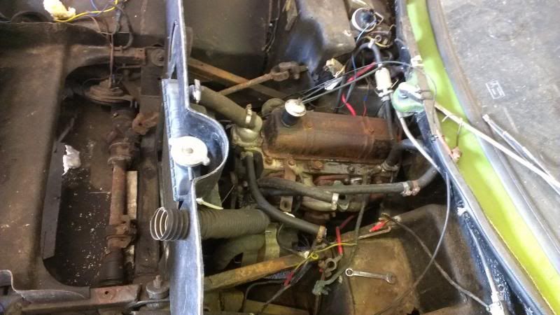

Well got it outside tody and gave it a run. It did smoke again, BUT it did eventually clear. If its OK tomorrow after sitting again, then I'll be pretty happy....if it smokes again, then theres obviously an issue! It does miss a bit, but the carb is mish-mash of parts so that won't help....if anyone has a 1.25 SU thats known good, I'm in the market for one!! :)
The car has no keys, so made the boot lock fit an old key, and scimmy Mike has some door locks for me. I dont think it has had a steering lock, but unsure :? It seems to have been dash mounted ignition, and I have one of those rigged up for now anyway. Only lock Im short of is the bonnet lock now.
The wiring.....what a nightmare. I cant do wiring, so this is just my worst 'mare. Ive tried so hard today, got nowhere and just glazed over :lol:
Firstly, the only complete switch is a HRW one, in a car without HRW :lol: The headlamp switch is broken, and hasnt enough wires anyway.....and Ive no idea what switches I should have anyway :? :w :w Theres dozens of wires just dangling about, plus modifications, extras, sellotape, scotchloks, you name it.
The ignition circuit evidently has what it needs, and occasionally the front indicators work. But thats it! No guages, no lights whatsoever, no wiper, fan, nothing...zilch. Oh, I do get the oil light on as it should. I just dont know where to start.... :cry:
