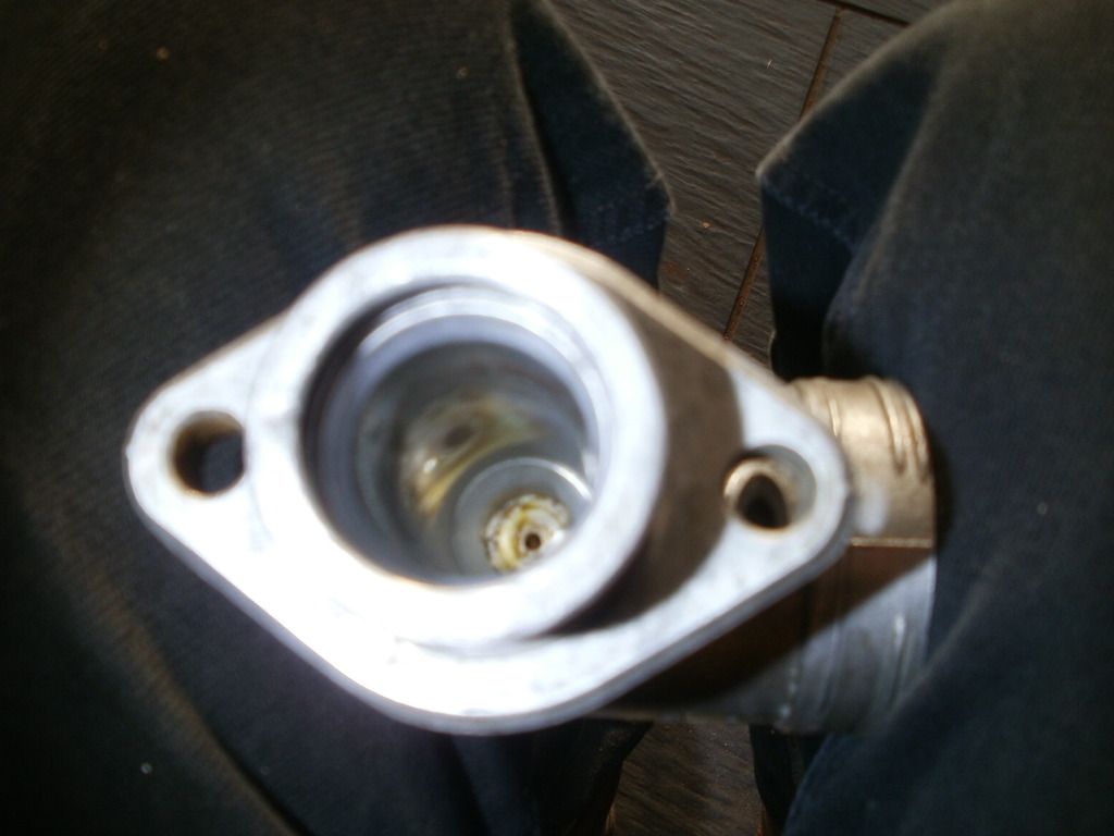

I've been very lucky, as the internals were still in vgc, it was just the first couple of millimetres of the piston that had corroded where it meets the air, and the bore where seal runs is still perfect. The brake pedal is a bit stiff though, even without the BMC connected, so will need re-greasing
Cleaned the body up with a brillo pad as I thought blasting it would have left too rough a finish.

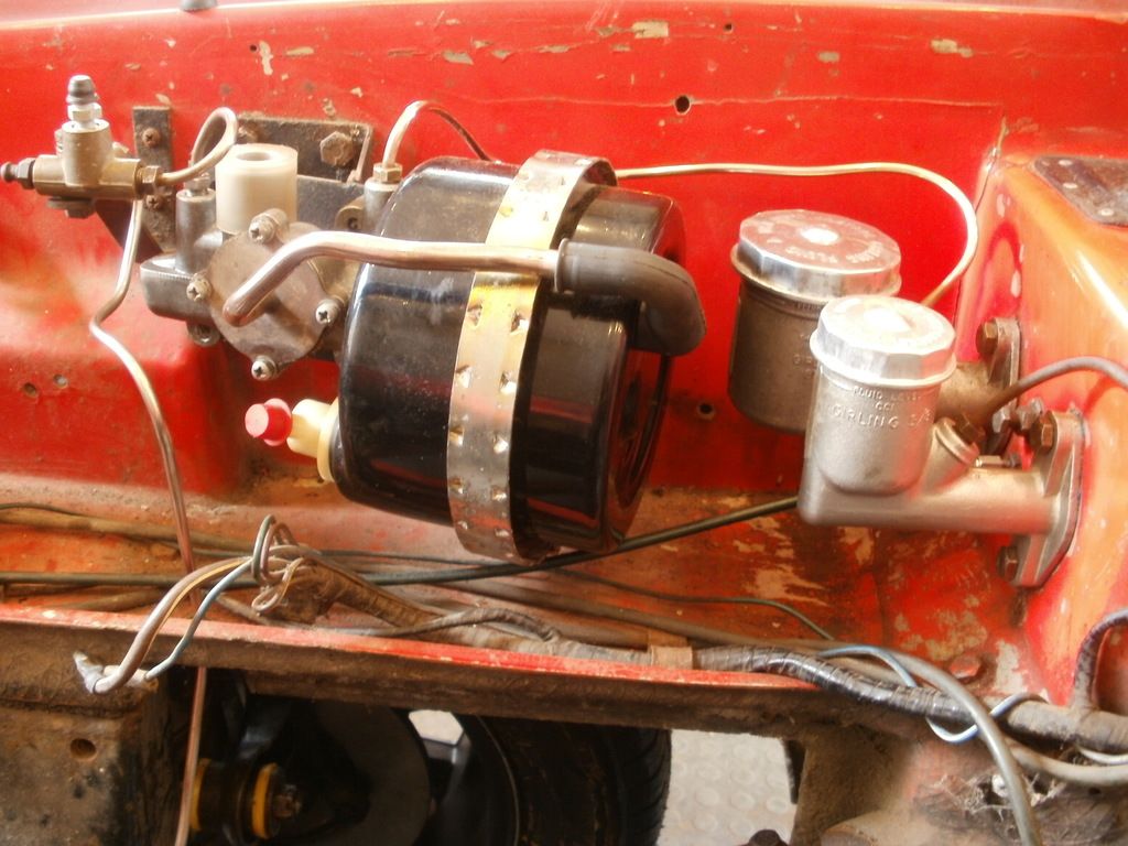

The brake master cylinder is now reassembled, the pedals freed off & the brake light switch overhauled.
The clutch master cylinder that was previously fitted was a standard 3/4" Scimitar item, and as this Scimitar is far from standard with its SBF engine, it was not well matched to its Sunbeam Tiger derived slave cylinder, giving a heavy, shortish pedal action.
I did a bit of research & found the Tiger used a 5/8" master, so a Wilwood replacement has now been sourced & fitted. That should lighten the pedal by roughly 20% and give a similar increase in stroke.
The new diaphragm clutch pressure plate should also improve on the previous spring version.
When the local autojumbles come around I think a more period looking alloy cap will have to be sourced to make it blend in a bit better....

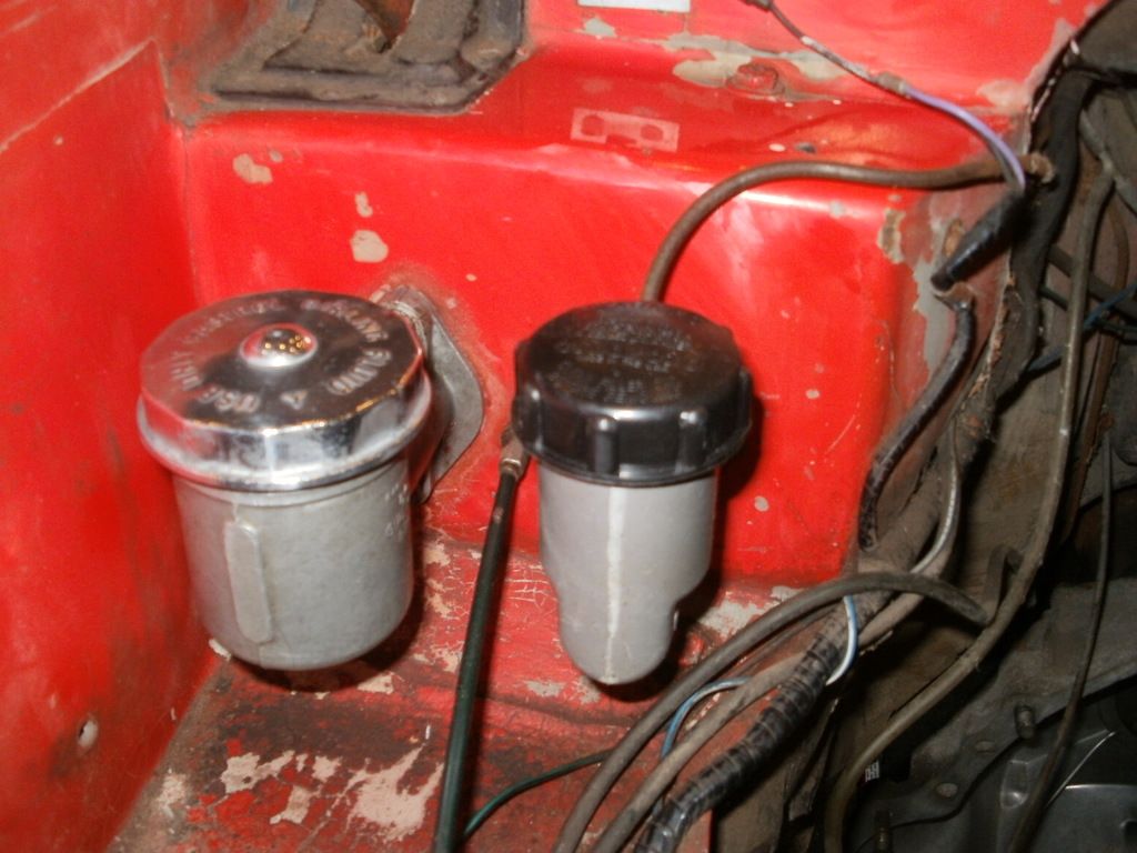

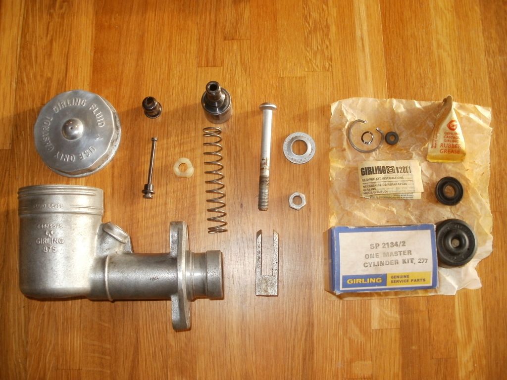

The autojumble at Weston park festival of transport yesterday came up trumps with a complete NOS Girling 5/8" clutch cylinder, so that has been swapped this morning. It looks a lot more "period" with its alloy cap.
I need to fit the front calipers & purchase some brake hoses then hopefully the brakes will be operational again.

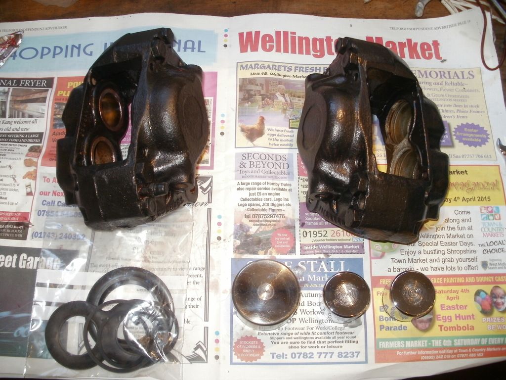

One of the brake calipers I had rebuilt many years ago turned out to be a bit sticky, so decided to strip both of them down again & found one of the pistons had started to corrode.
This time I've reassembled the seals with red grease only. The previous combination of using brake fluid as a lubricant & having them sitting around for years obviously was a recipe for corrosion.

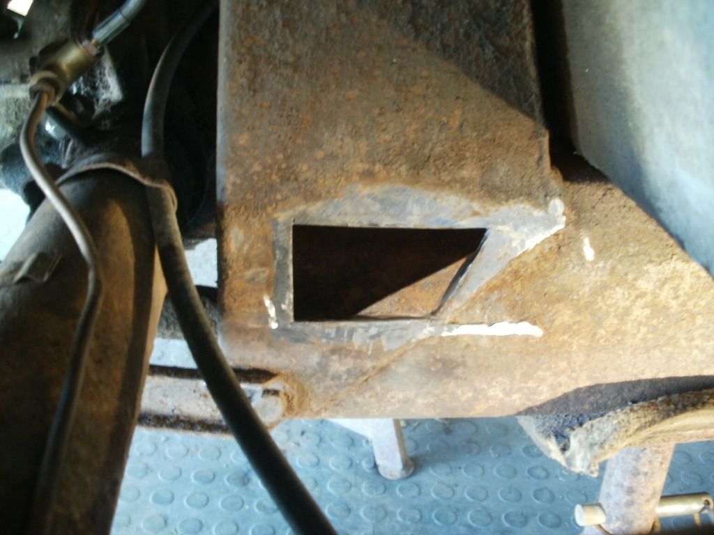

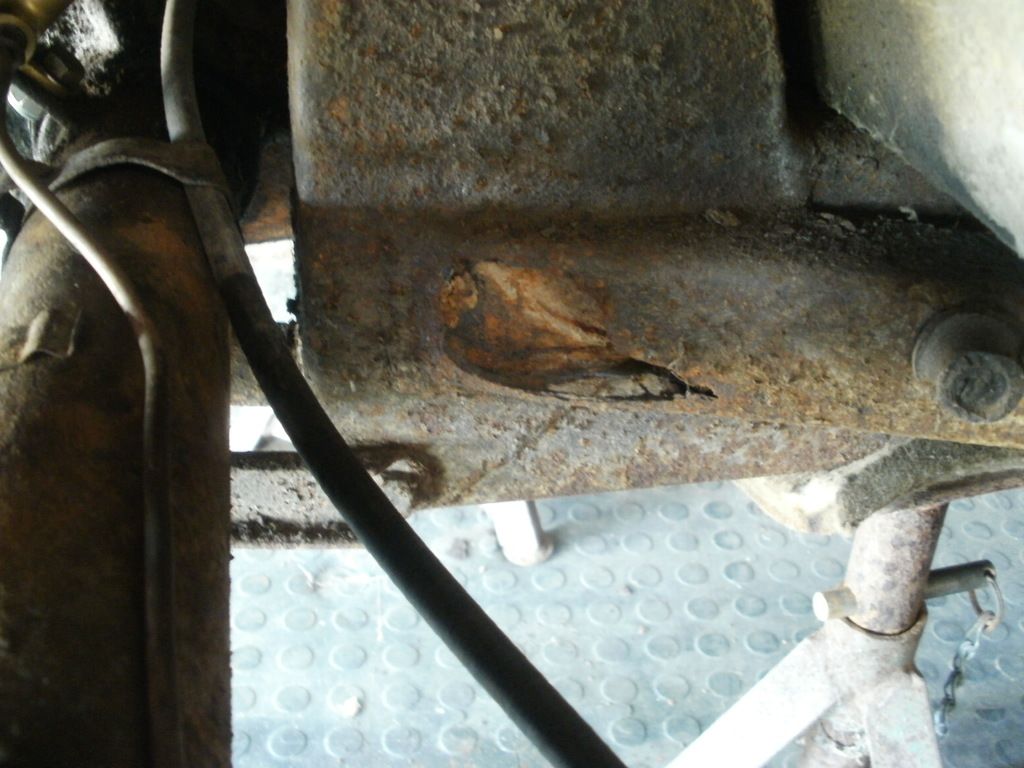

The rear diagonal has the usual problem

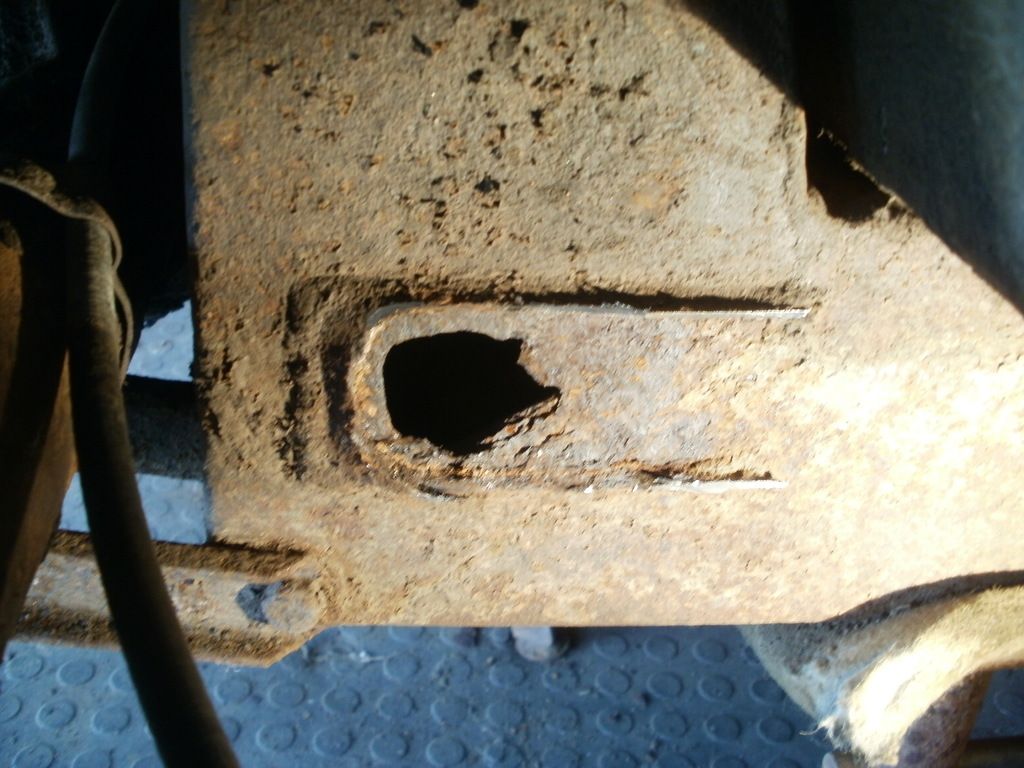

When cut back it revealed the usual hole
So chopped a piece out so we are back to sound metal. Awaiting some steel plate to arrive in the next couple of days so a new piece can be let in.
The rear tube is solid so I'll weld a new diagonal straight onto it.

At least it looks quite localised, so should be relatively straightforward to fix. Apart from a bit of surface rust the rest that you can see, looks pretty sound?

The chassis in general isn't bad at all, as you say Roger, apart from the rear of the diagonals & front outriggers (Coupe type) its just surface rust.
The plan of action is a quick wirebrush followed by a brushed on coat of ACF50 to keep most of the rust at bay until the chassis is galvanised in the future.

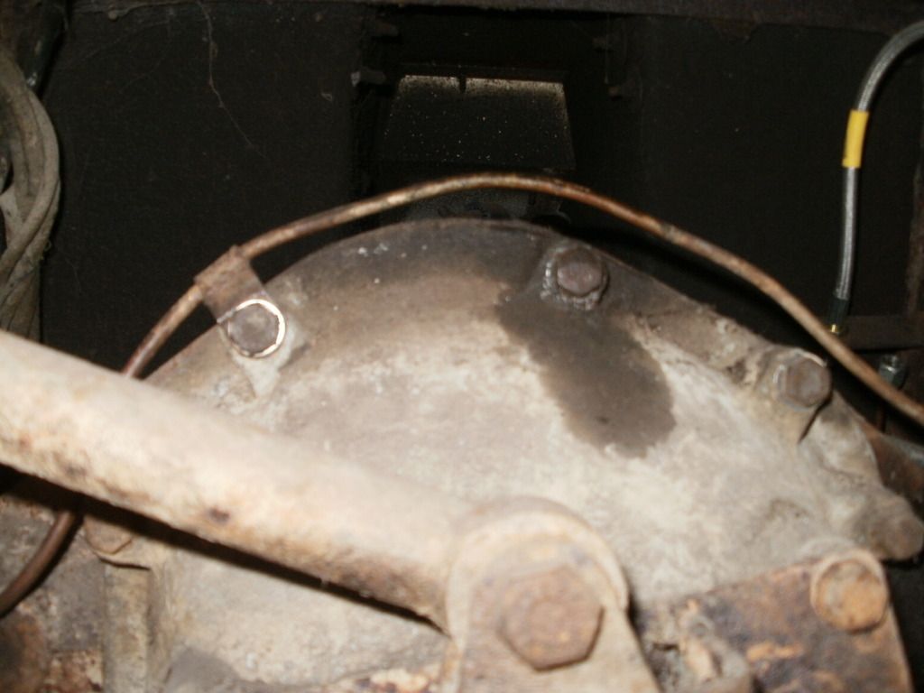

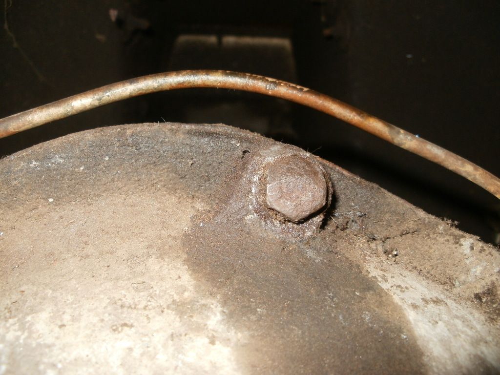

One thing I noticed after I had taken the petrol tank out & was sitting under the car perusing was a bolt at the top of the diff had been rubbing on the crossmember above it. There are no bump stops fitted which is obviously the reason for it catching so I will probably fit some of the polyurethane jobbies directly onto the shock absorber damper rods assuming I can get the tops off.

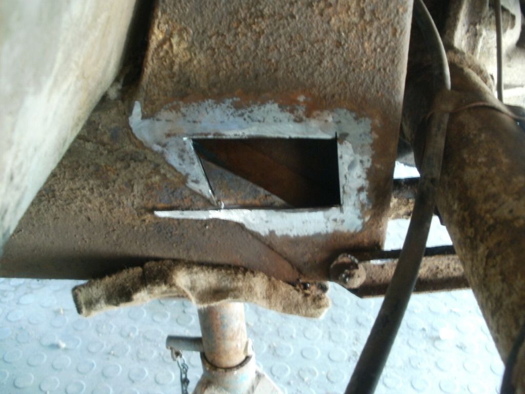

Here is the other rear diagonal rust trap chopped out & ready for welding as soon as the steel arrives
