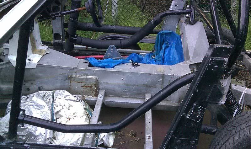

more parts collated.
An uber cool carbon 'tart' part, a manifold from Australia, a Ford V8 Falcon engine component :wink:, some new bits for the new diff and sourced some other parts to be purchased. Rear suspension is almost decided upon, designs 90% there, just a couple of pickup points and source for 2 items left. Rear discs may need changing too.
Front suspension i have 3 conflicting ideas, i have one mocked up, think ill end up mocking one more up before i commit.
Hoping to collect a spare rusty chassis to practice the surgery on before hacking up the galv chassis.
Fuel system Bosch 044 pump, swirl pot etc is all bought except fuel lines. Still need to commit to an engine and box combo, but the idea is to see what space can be made in the tunnel and that should help make that decision

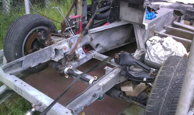

Post by CNHSS1 » Wed Jun 15, 2011 10:03 pm
not really mate, just have good direction on all other areas, engine/box combo is least important in the scheme of things.
few have asked to see the car as it is....
not exactly inspiring im afraid.
picked up a spare non galv chassis (thankyou Dave 'Mr http://www.sporting-reliants.com' Poole 8) ) to use as a guinea pig for the surgery.
well beyond repair, but perfect for hacking about rather than using the galv one. All mods can be mocked up and then transferred over if they are suitable.

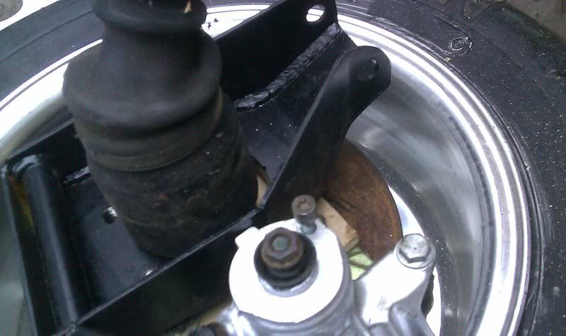

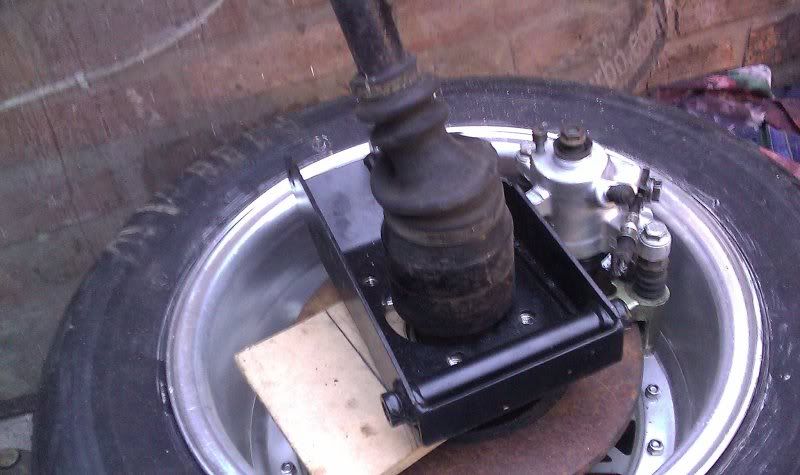

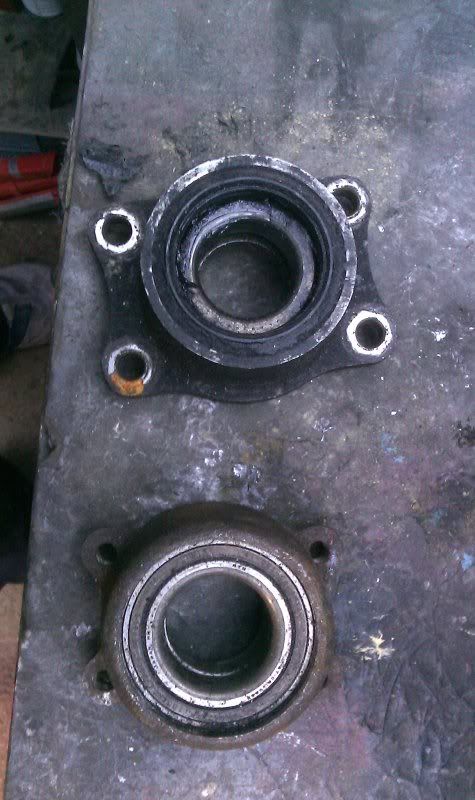

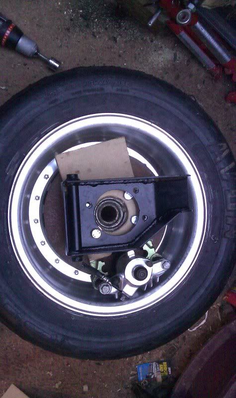

Post by CNHSS1 » Fri Dec 30, 2011 10:41 pm
as it was slashing down wit rain all day so couldnt play with the TVR or SST, thought id crack on with the racer.
pics show Ford drum brake bearing carrier that the rear uprights are designed for, and the ss1 versions i want to use.
good old MDF to mock up the adaptor plate to mount the bearing carrier and the caliper.
Calipers will be VAG ally calipers but using the Raldes sliding caliper carrier mount as the offsets better for my needs
not a lot of caliper to wheel inner clearance either. 240mm discs and 13" wheels. In fact they wont fit with cast ally rims only spun ally split rims
