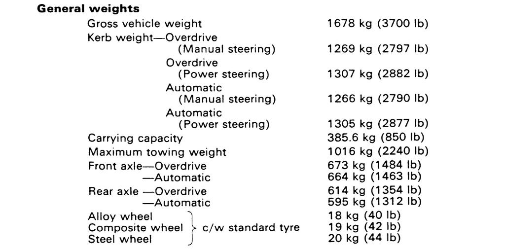

Post by Roger Pennington » Fri Oct 30, 2015 12:53 am
Hi Michael, The Se6a weights from the Reliant Workshop Manual are as follows:
Hope that helps :)

Post by speedy555 » Fri Oct 30, 2015 9:50 am
I wasn't far out then :) 1016kgs it is.....

Post by Coastline » Fri Oct 30, 2015 1:39 pm
Roger Pennington wrote:Hi Michael, The Se6a weights from the Reliant Workshop Manual are as follows:
Hope that helps :)
Brilliant. Many thanks Roger.
