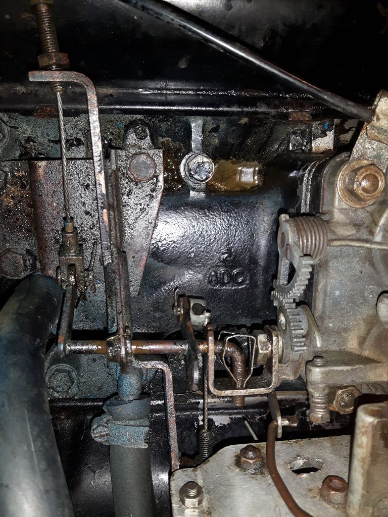

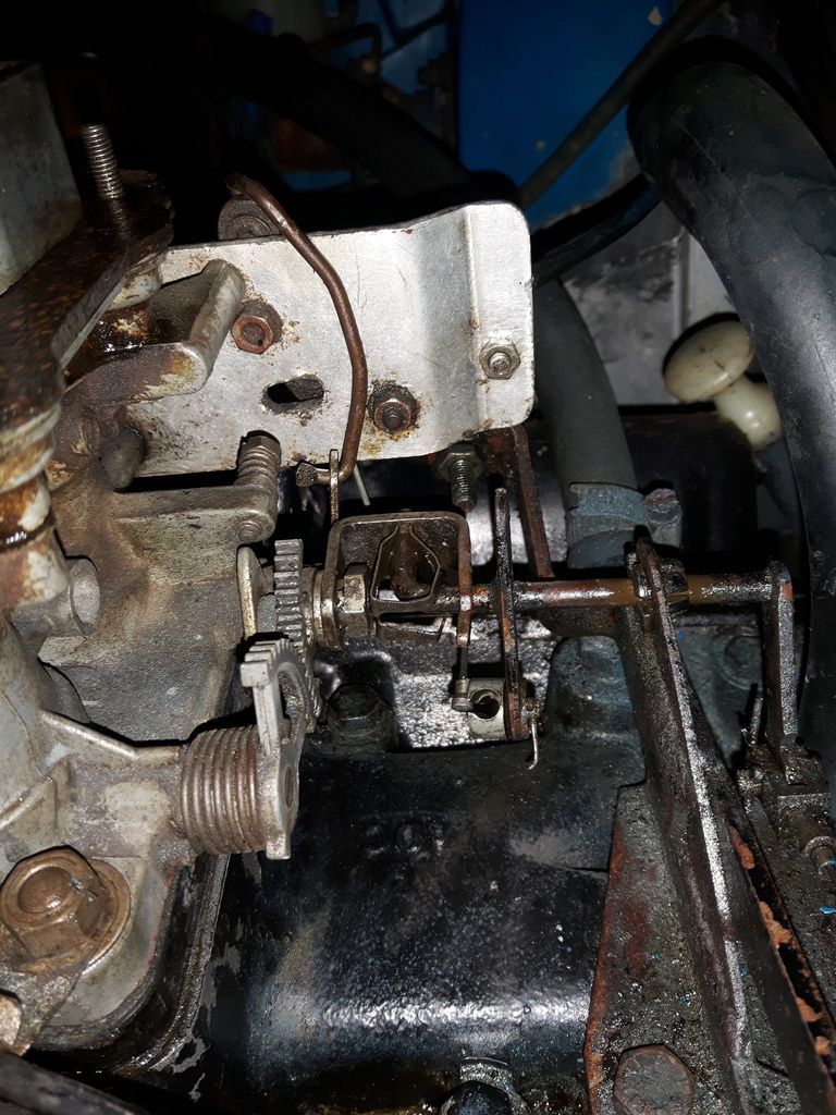

The next problem I have is the accelerator cable has snapped
Scimitar will not start
Posted: Thu Feb 28, 2019 9:17 pm
by noel6071
[image]Image/image]
Posted: Thu Feb 28, 2019 9:26 pm
by noel6071
[imageImage[/image]

Hard to see but are you sure the cables snapped.Looks like the end has just pulled through the hole in the linkage ?
Posted: Fri Mar 01, 2019 7:40 am
by noel6071
rebel alliance wrote:
Fri Mar 01, 2019 12:34 am
I checked it again its not snapped just was out of the linkage, when pressing the accelerator fully it jams up and doesn't spring back like it should there seems to be some issue with the spring back mechanism on the carb
Posted: Fri Mar 01, 2019 8:04 am
by Oldconn
Is it an automatic? I think I can see a cable connected to the end of the throttle spindle, going down the back of the engine ? Automatics have a relay to prevent them being started in gear, which could be failing/faulty, causing your problem. If it's an automatic gearbox, you need advice from someone who owns one.
Posted: Fri Mar 01, 2019 8:19 am
by rebel alliance
You should have a throttle return spring as well as the one built in the carb looks like its missing...any spring will do some on ebay

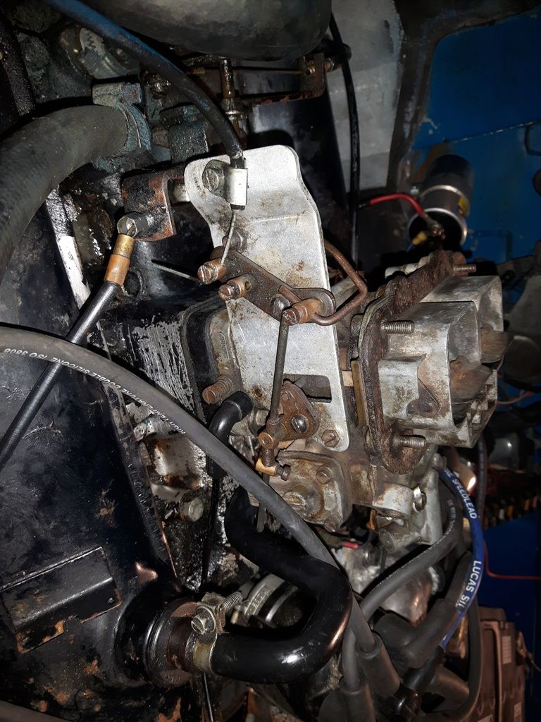

That could be the problem its certainly not springing back into place, its an automatic if anyone has any picture of this part of the carb where the accelerator cable joins be much appreciated

Posted: Fri Mar 01, 2019 8:46 am
by noel6071
[image]Image/image]
