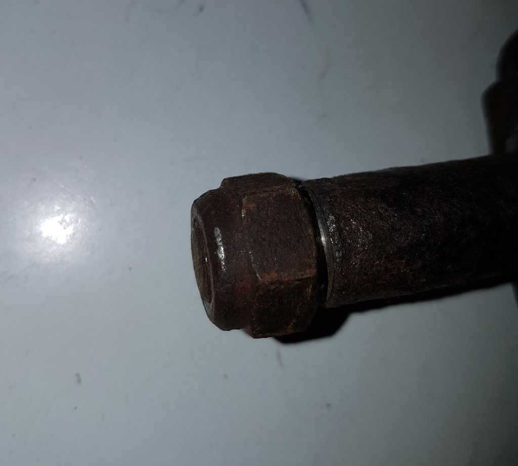

To illustrate the point, here's a nut screwed as far as it will go onto the fulcrum. note: the gap behind the nut is unthreaded, for a washer.

In the Moss TR6 catalogue they offer a nyloc for the top fulcrum, thinner nut? I wonder

Probably a "half nut"?

I think a split pin is a safe bet and i really can not see why a nyloc is an improvement ?
