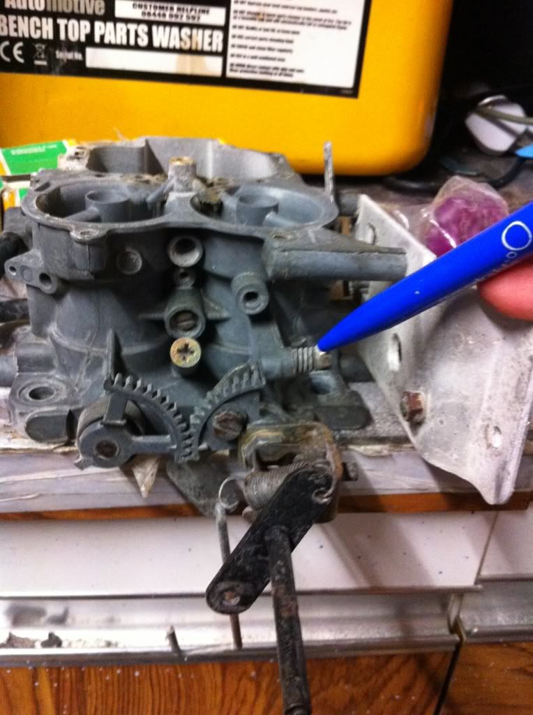

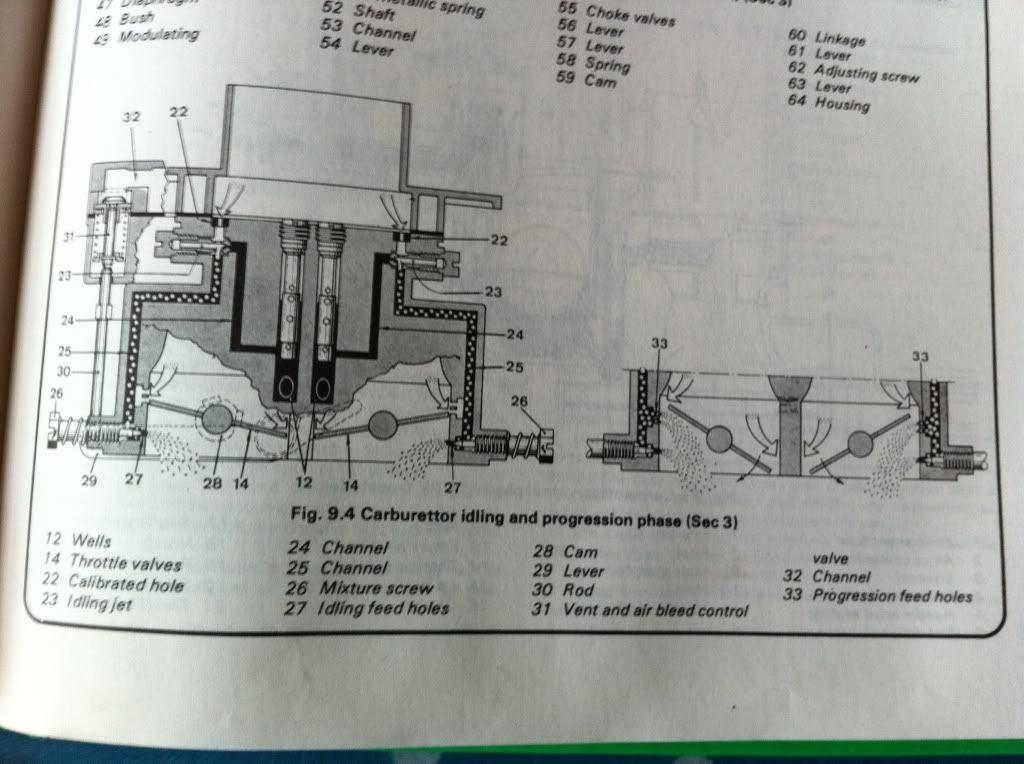

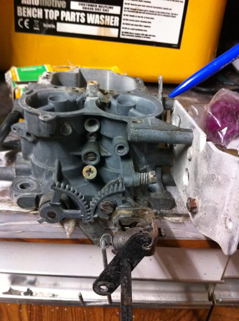

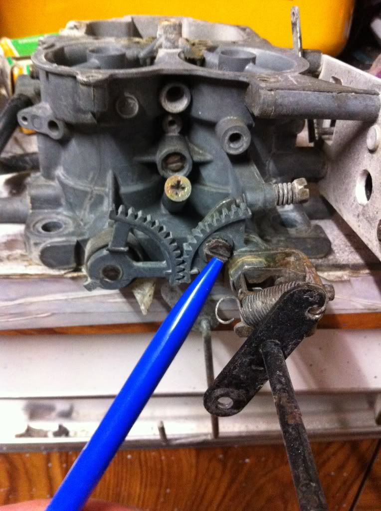

Below is a diagram which I hope will explain why I keep going on about the progression holes :-)
Left is at idle right is with light throttle
Adjusting the throttle values isn't anything to be worried about.
Back off this screw
And the thd one that would be here if a had an auto choke carb to hand.
Then loosern this screw
The right hand throttle value will now move independent of the toothed segment. The left hand value should now cover the progression holes. Move the right hand one to do the same. Take out the backlash in the toothed segment and tighten the screw. Now tighten this screw
Untill it comes in to contact, adjust thd other one as required.
Hopefully at least some of that makes sence.
